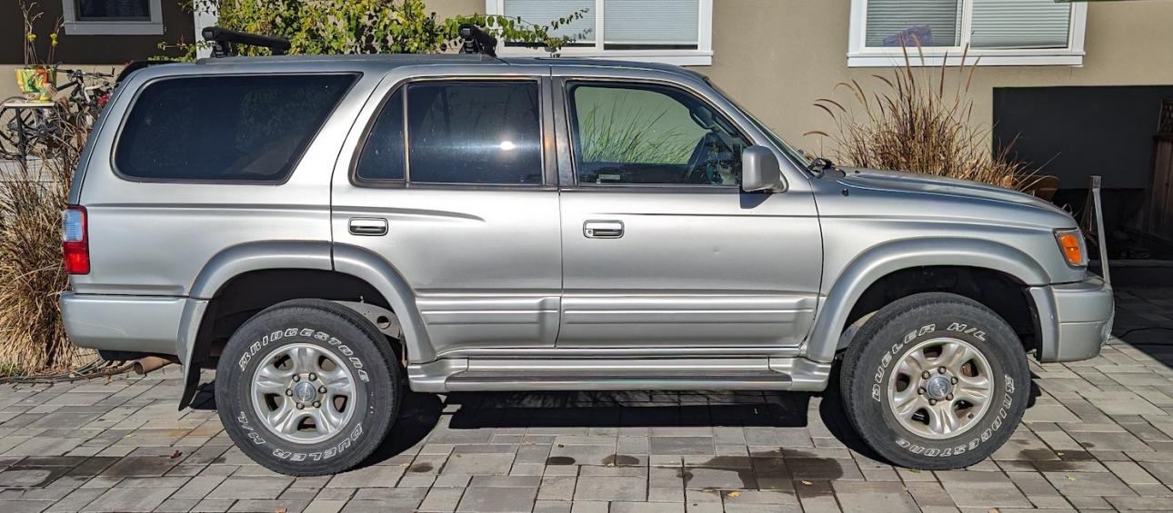

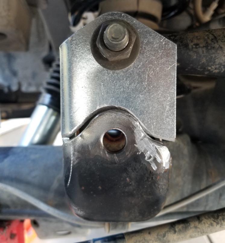

I have a mostly original 2001 Limited. Like you mention, my suspension was tired. Don't let the tires fool you, it's had a very hard life. So, I just did this upgrade 2 months ago.
Front: OME 880 + Bilstein 5100 (on lowest perch)
Rear: OME 906 + Bilstein 5100
Here are the measurements I recorded completely unloaded, fender-lip to hub-center.
Before Install (tired original springs):
- Front: 20"
- Rear: 19.5"
- Panhard Bar Dvr-Pass = -1"
After Install (OME 880/906):
- Front: 21"
- Rear: 22(dvr), 21.5(pas)
- With Axle Side Panhard Correction: 0"
The 880/906 is a good combo that gives a slight forward lean. That works for me because I often carry stuff in the back. There are panhard correction kits with axle and frame extensions. I installed the axle side only (since the lift was very minor). I am very happy with this setup.
Note: there is a small dvr vs pass side height difference. The OME springs are side specific, with that difference to account for gas tank load. I think my tank is pretty empty at the moment.
