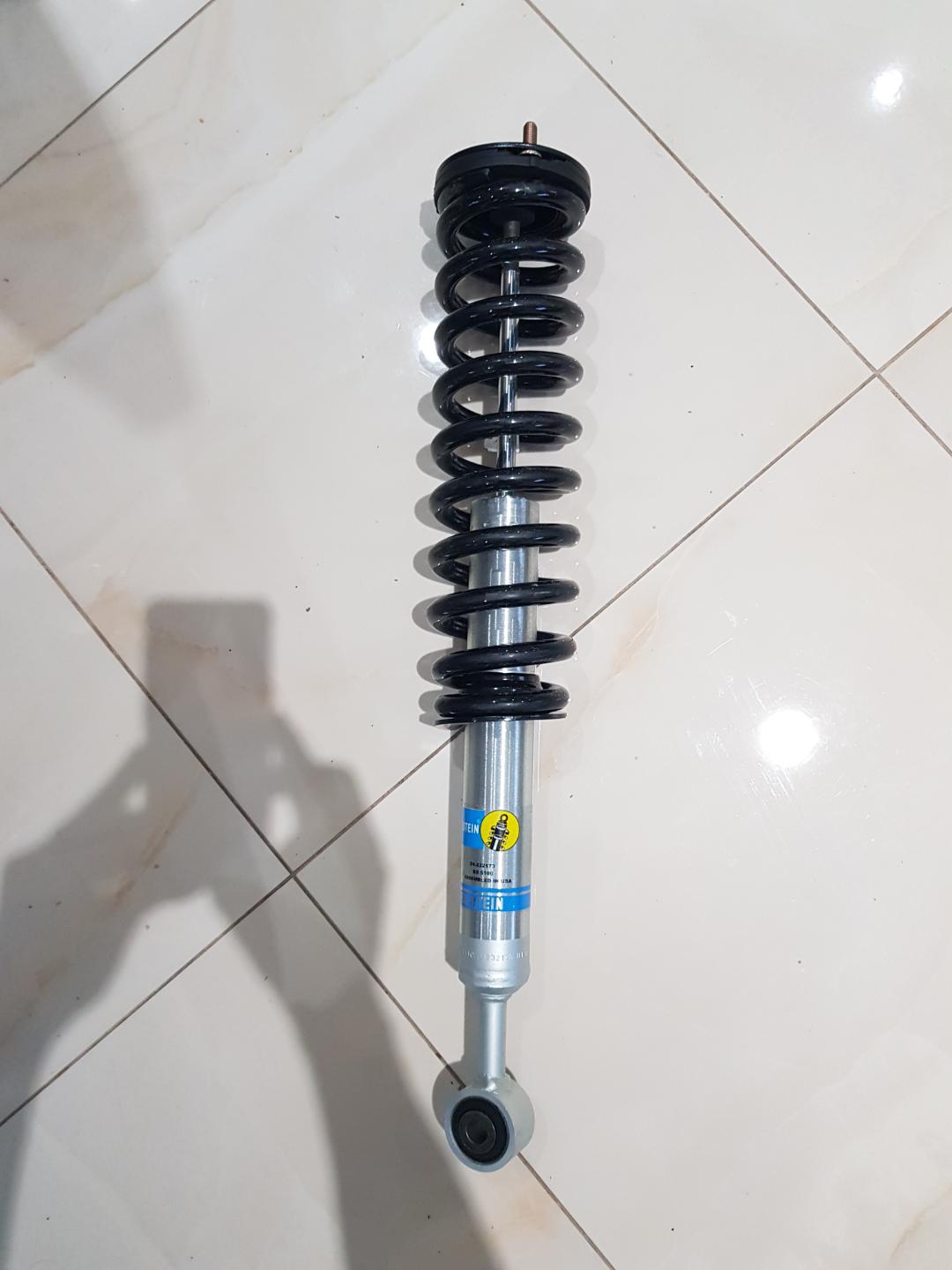

I'm wondering if there is something wrong here. I bought the Tundra 5100 front shocks as recommended. I also got some OME 881X springs which I understand will give me a 1.5" lift or so on the lower perch. But comparing the length of this assembly to the stock one still on the car, the lengths are totally different. The distance from the bottom of the perch to the centre of the lower bolt hole is 11" but on the original from Toyota, it is only 6". How is this possible? I put the spring on the strut and I don't even need a compressor, the top hat slips right over it.
The shocks say
24-232173
B8 5100
Maybe I didn't specify the year of Tundra correctly?
These are them
Bilstein 5100 0.87-2.28" Front Ride Height Adjustable Shocks For 2007-2021 Toyota Tundra

I used the Tundra specific shocks from a 2002 model with the Tundra TRD Springs also from a 2002 model so the shocks were matched with the springs. Sometimes that matters and played it safe with mine.
Yeah that's the reason. Those Tundra shocks are for 2007 to 2012. These are the ones for 2000 to 2006 which look similar length to the 4runner ones:
Bilstein 5100 0-2.3" Lift Front Shocks for 1996-2002 Toyota 4Runner
Great, now I gotta get rid of those Tundra shocks. I guess I'll just get the 4runner shocks? What's the benefit of the 2000-2006 Tundra shocks over the 4runner ones?
I believe the reason people do the Tundras is because they have 5 perch settings as opposed to the 4Runner's 3 perch settings
They are also valved stiffer and have a longer extended length (by a bit, not the giant amount for the later gens shown above).
