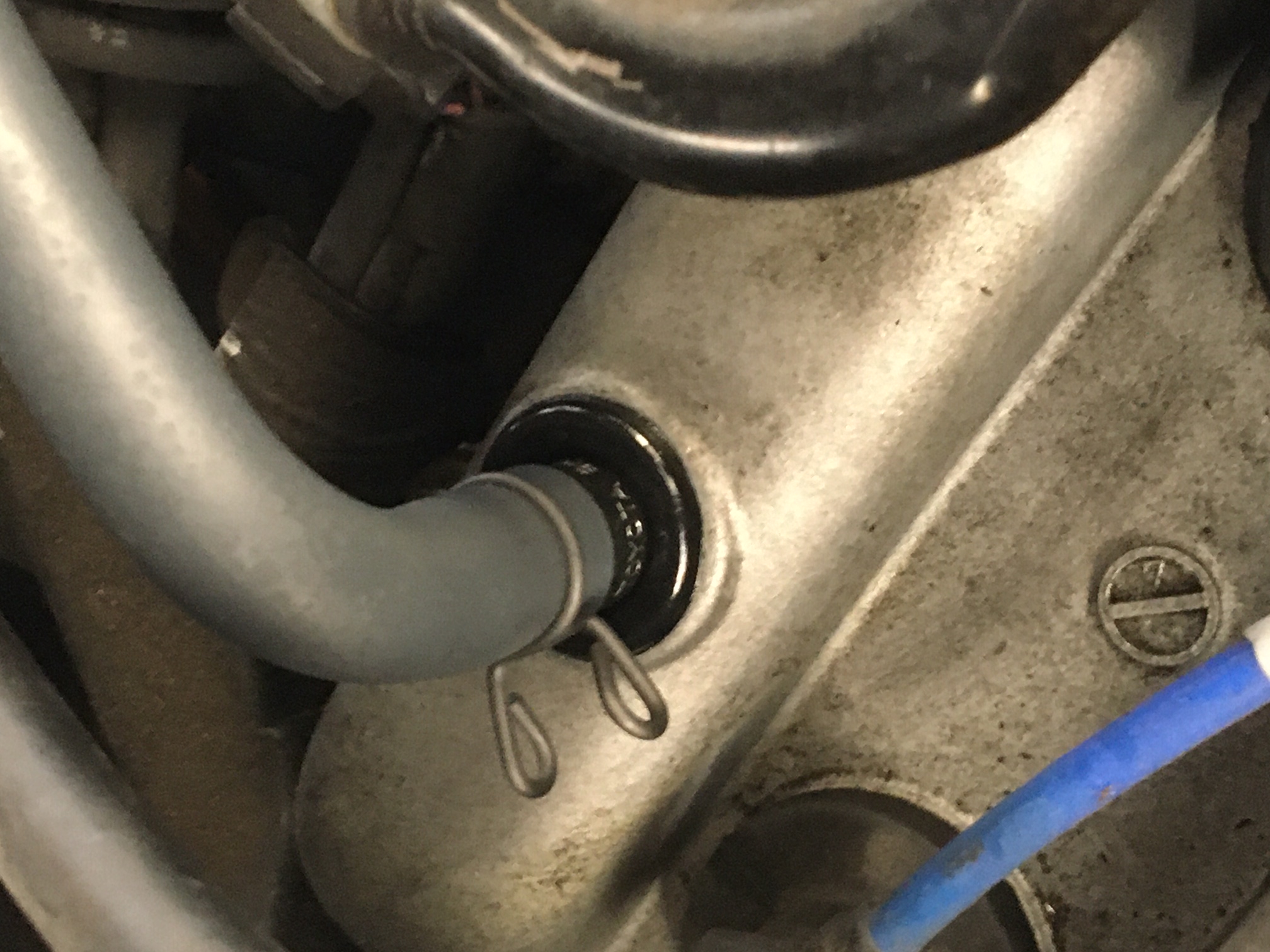

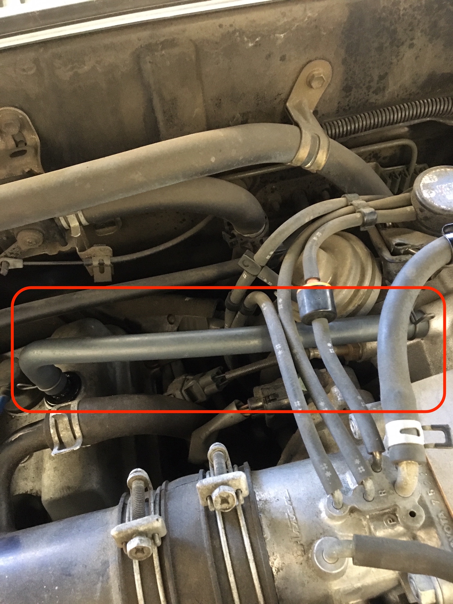

Hey all,

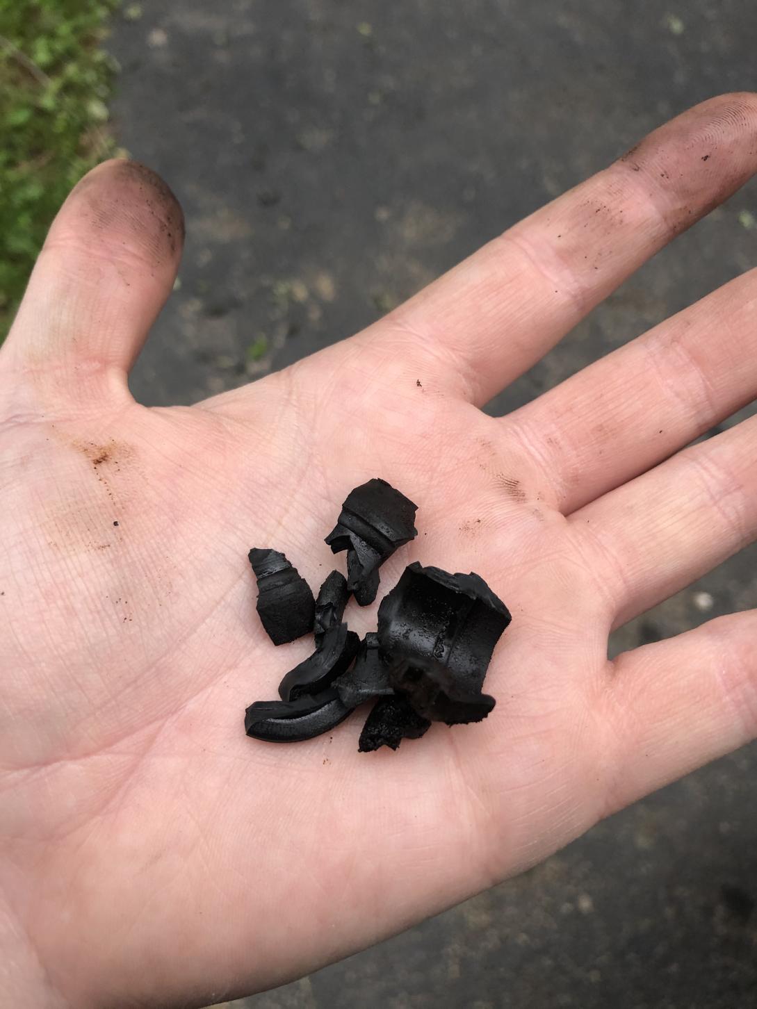

Just finished this install and wanted to share some pics. It's a really easy procedure, although the brittle grommet can be a PITA. I had to go fishing for parts of it that fell in while I was trying to remove. It was super brittle!

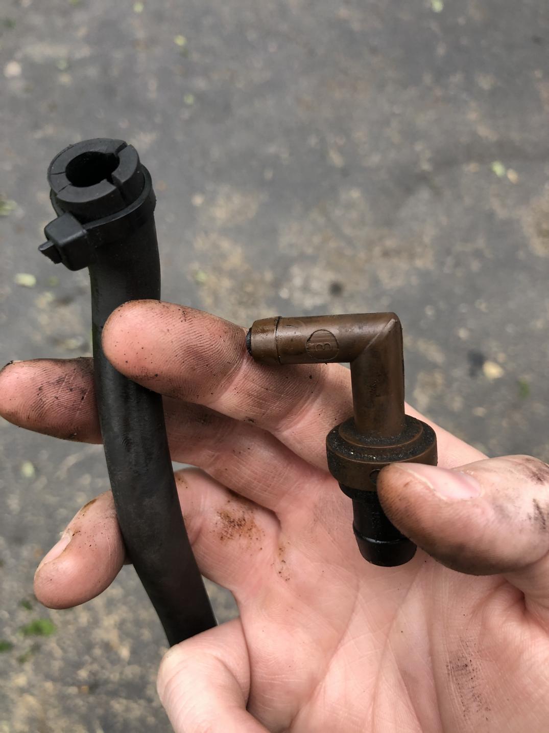

Note, I also noticed a ton of metal shavings in the area below which was somewhat unsettling. You can see what I'm talking about in pic #5...

Mine was like that. Don't try to grab the top with pliers or something or attempt to pry the upper lip as you will probably break it. I pulled mine after 15 years by working on a still warm (not hot) engine, and using a seal pick with a 90° tip that let me pull up on the bottom edge. I worked it around pulling a little bit harder each time as I worked around the bottom edge. When it finally popped, it went 10 feet in the air but stayed in one piece. I did spray some PB blaster around the edge before I started.

I didn't use the point, I put the elbow against the bottom inside edge.
Metal shavings? Dun dun duuunnn...
Might want to change your oil soon in case some of them dropped onto the heads & camshafts.

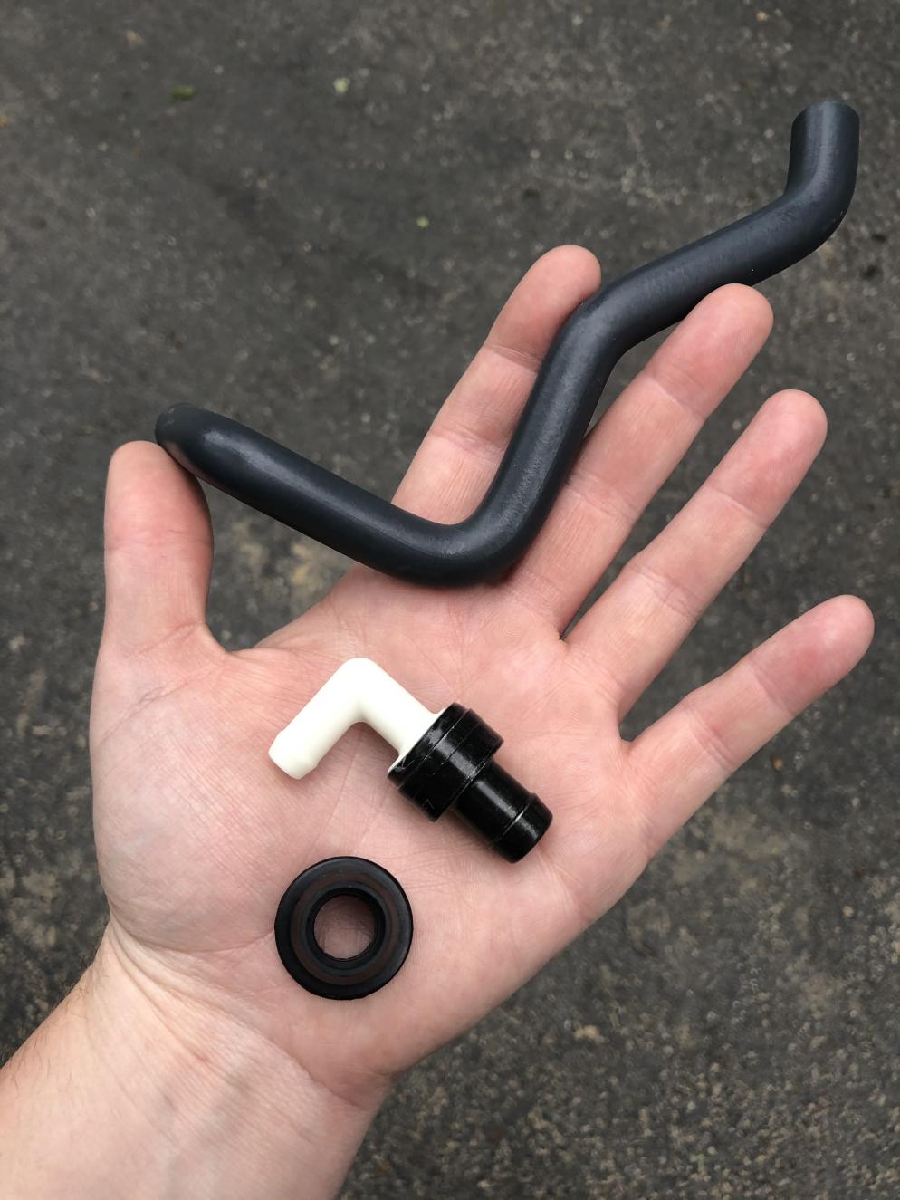

12204-62010 - PCV Valve
90480-18001 - PCV Grommet
12261-62041 PCV Hose
My PCV hose was cracked so I replaced it as well.
Things I wish I would have known before starting:
if you search Ebay using the hose number, you will find kits that include all 3 parts for less $$$. I bought all 3 parts separately and wasted $10 bucks.

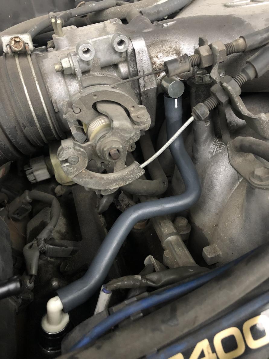

Also, I am about to replace my vacuum line following THIS THREAD... if you plan on doing that, then skip ordering the hose all together.
Don't be afraid of doing this job, I had several pieces of the old grommet get pushed down into the housing, but I was able to fish them out pretty easily with picks and pliers.... No big deal.
- I sprayed the old valve/grommet with WD-40 two days before removing it. (I also removed while the engine was warm)
- The valve popped right out. I fished out the crumbling grommet right behind it.
- Push the new grommet in first, use a tiny bit of oil if needed
- Pop the new valve into place
- connect the hose
- DONE

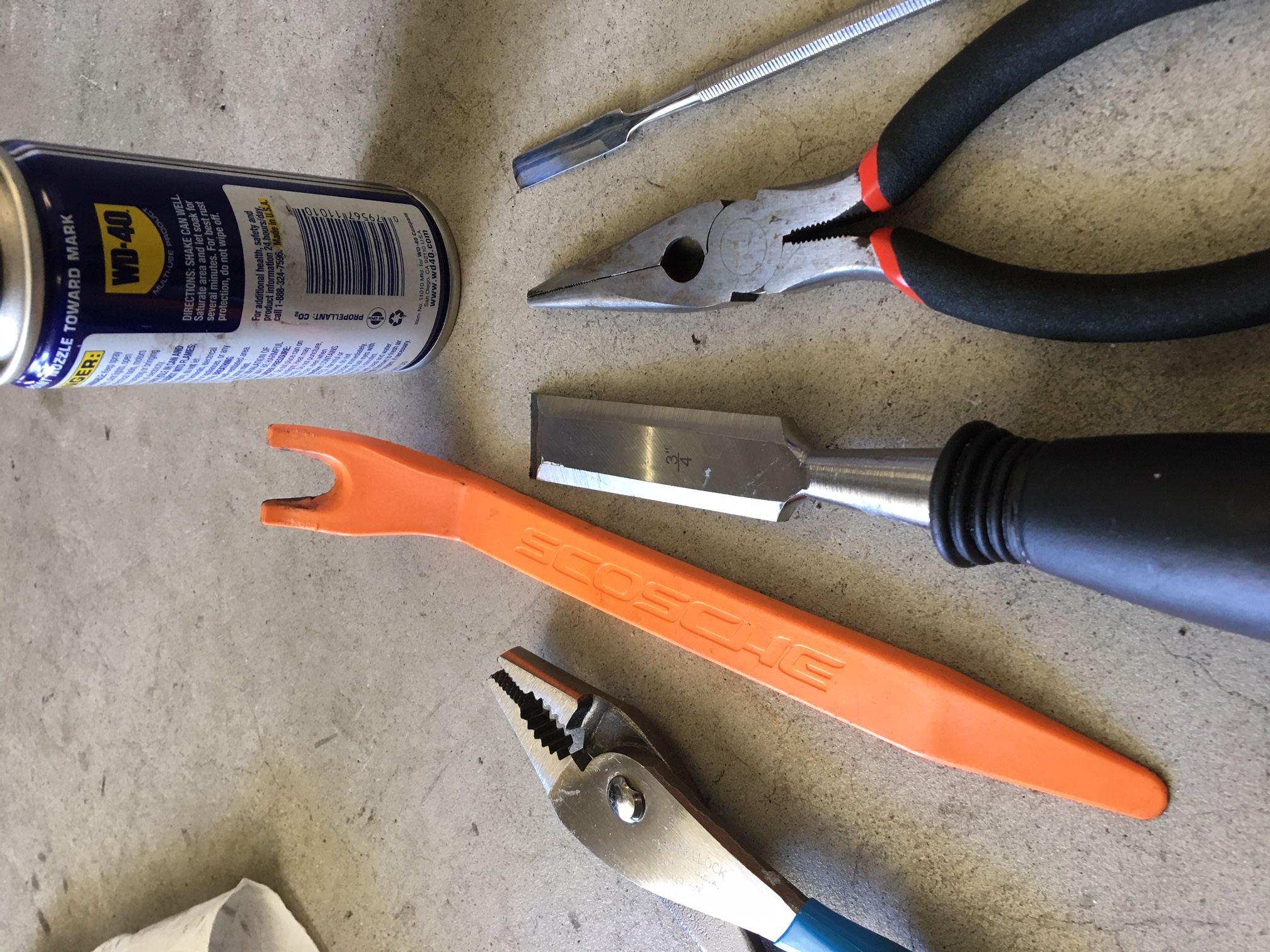

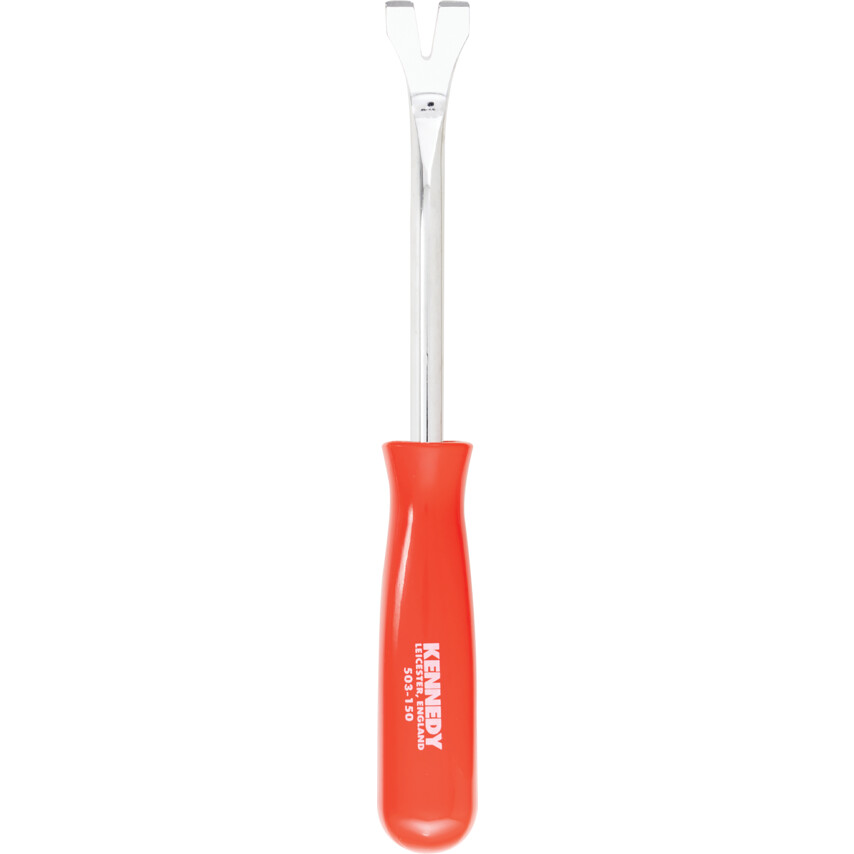

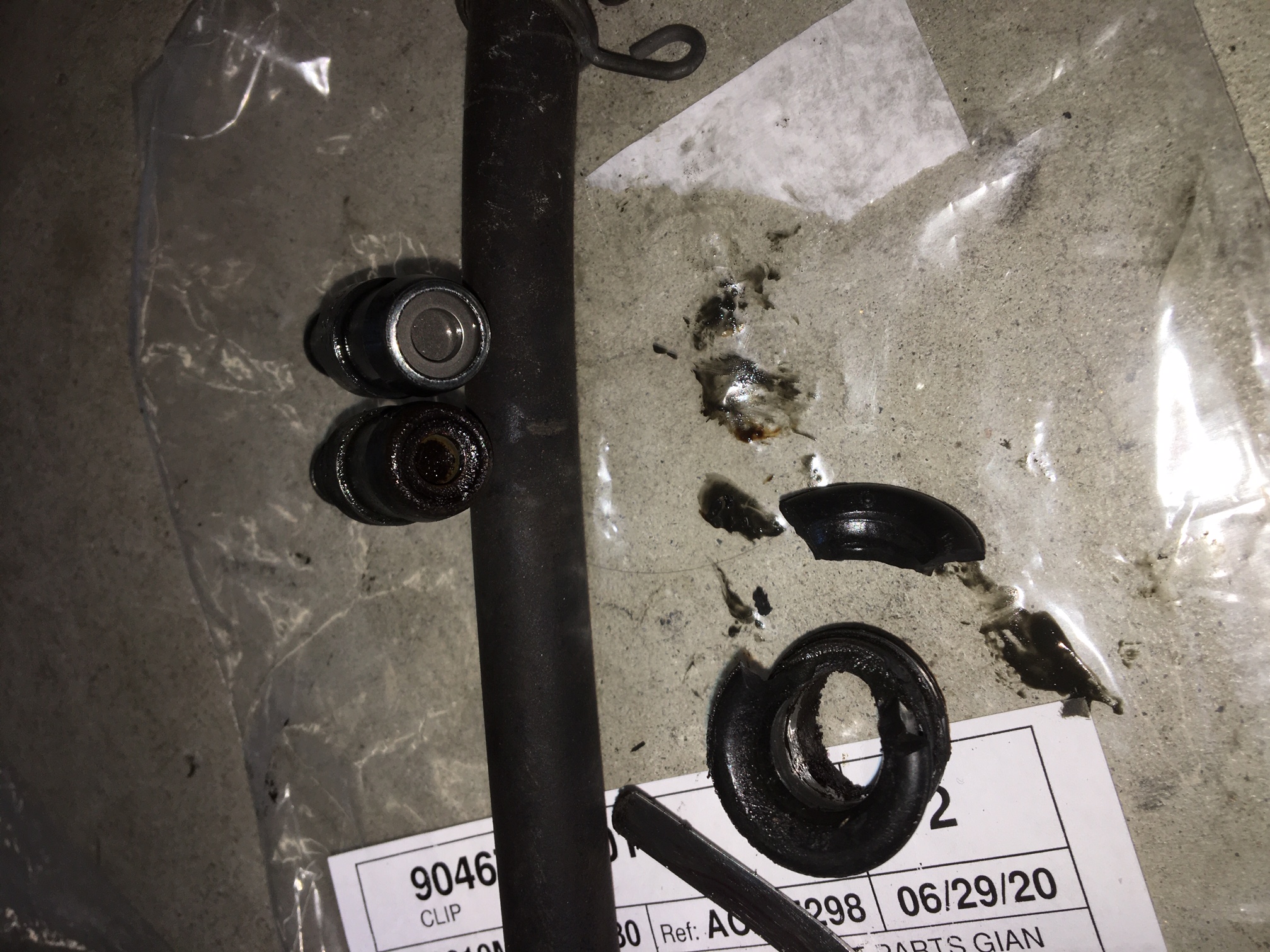

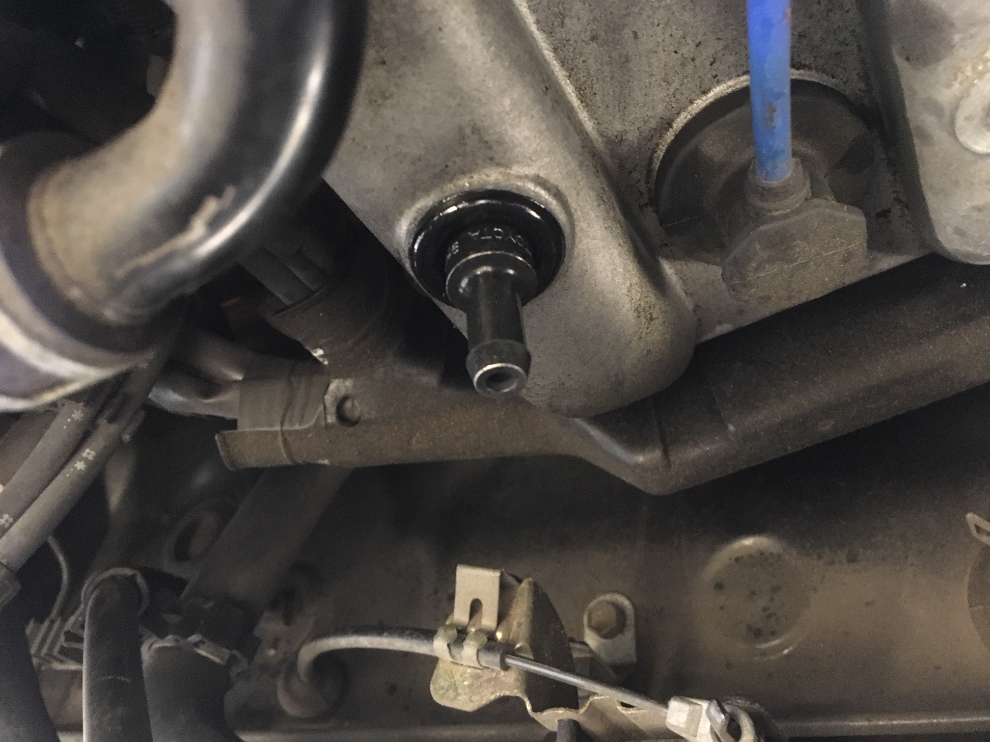

Thanks to all who participate on this forum! Replaced the PCV valve on my ’98. The old valve took some effort, a lot of rocking back and forth and wiggling. Pliers did the trick. Was nervous about the grommet but took it slow and worked it until it came really loose. It did break in two, but big enough to grab once I pried most of it out. Panel remover tool worked great for this.
I did warm it up by driving around the block a couple of times and used a lot of WD-40 to make removal a bit slicker. Installing the new parts was much easier, used WD-40 there also.
Parts list for '98 4 cylinder, ordered from Toyota Parts Deal, no issues there.
12204-75010 - PCV Valve
90480-18001 - Grommet
12261-75030 - Ventilation Hose
90467-14001 - Ventilation Hose Clips x2
Old valve and new valve plus old grommet in two pieces:
New PCV valve installed:
PCV valve close up:
Complete:
Tools:

I didn't have to take off anything in order to reach the PCV Valve. Just popped it out, fished out the crumbly gasket, and replaced all 3 pieces. Pretty easy job that can prevent loads of more expensive jobs.
