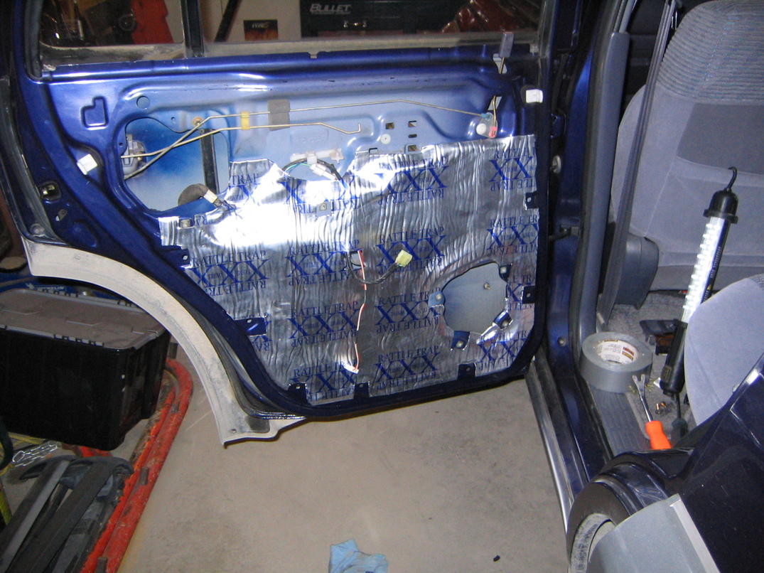

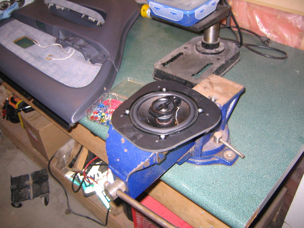

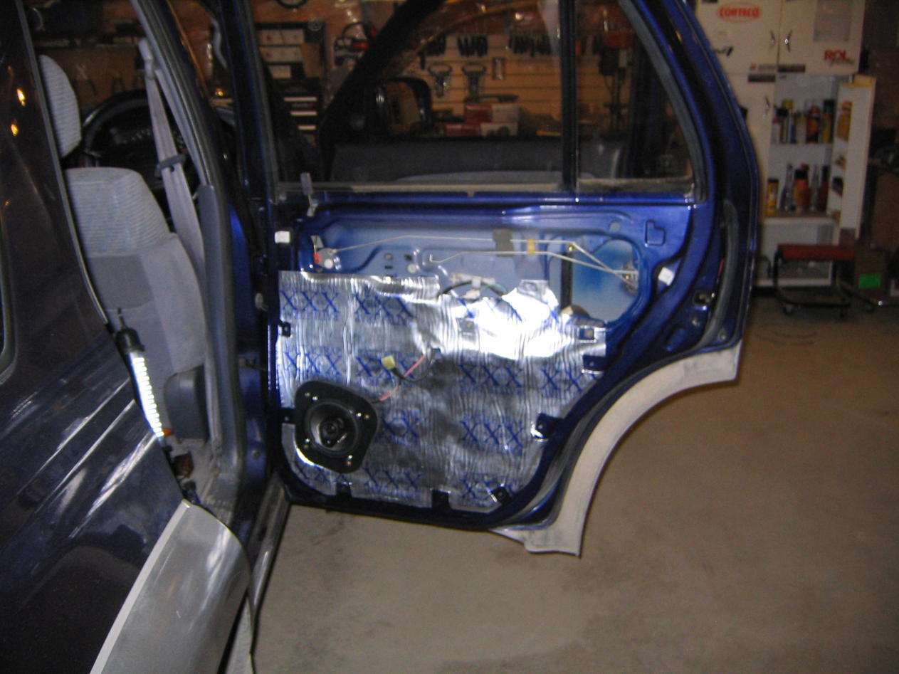

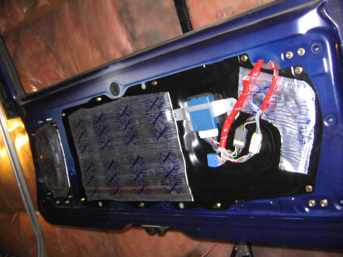

I did the rear doors/speakers tonight, this thread was a HUGE help! I wasn't sure if I wanted to tear the plastic membrane off, but your link to the door DIY was great as well.
The speakers are just some Pioneer 3-way 5.25's, but with the sound deadening they don't distort at all when cranked up. I'm just running the speakers off the deck so I didn't expect much, I don't listen to much loud music these days, more podcasts it seems.
I did just the inside wall of the doors, the Krown oil treatment I got does the insides of the doors, so it would have taken forever to clean the oil off to get it to stick, and would defeat the purpose of the oil.
I duct taped a rough section of the FATMAT material onto the door, and used a marker to mark where it needed cut to fit, made it easy to get the rough shape you need.
The doors have a deeper thud when closing them compared to the front doors now, so that's a good sign as well. I'd like to get rid of a bit of highway noise if I can, I get quite a bit of wind noise from my window visors on the highway as well.

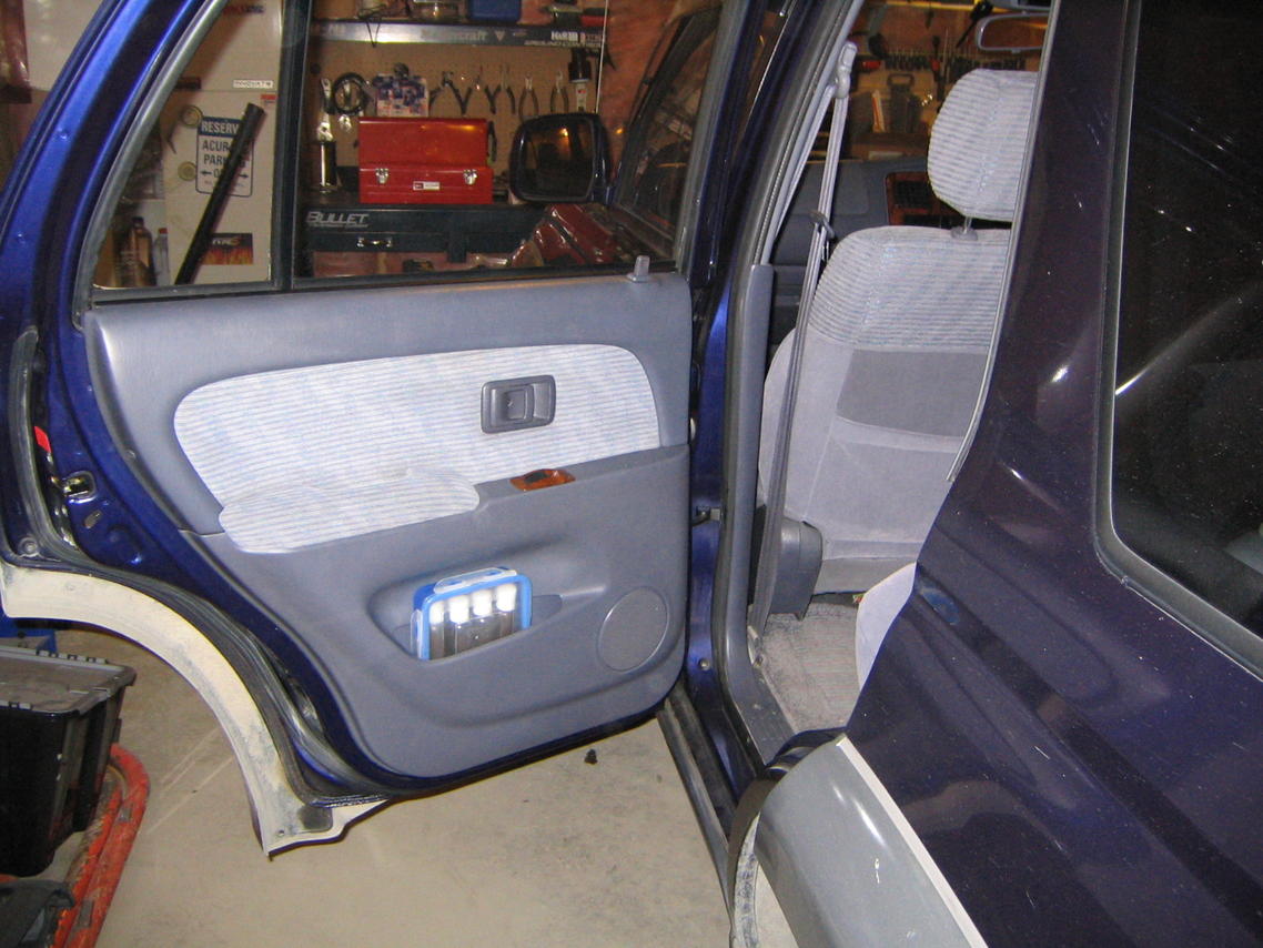

I gave the carpet on the door panels a good scrubbing while they were off as well. Snapped a few pics along the way:
