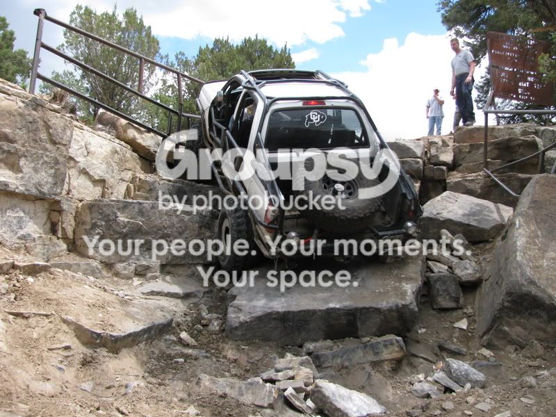

You could do a hybrid int/exo...make all the bars that normally would crowd headroom and put them up through the roof, and then back down...then you'll have a sweet roof rack too!
This is the best of both worlds. However, getting it to seal, fit tightly, and be functional is VERY hard to do.
Jeff's rig is one that I really do like. He claims it seals pretty good, but its very hard to say.

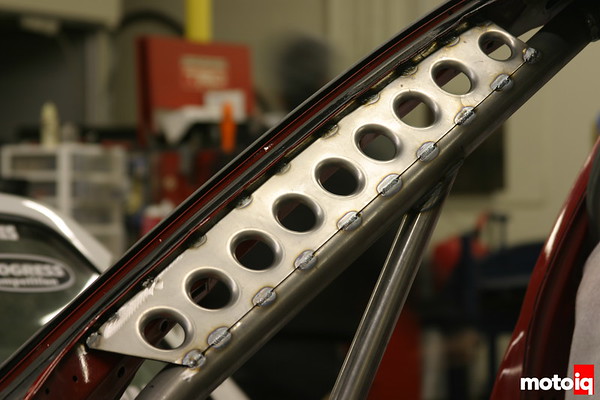

IMG_2667.jpg~original
This is one way I have considered doing it. Except, I would simply be using the dimpled plates to add to the factory chassis to help stiffen up the A/B pillars a lot more.

I dint realize he chopped the back. I saw some old pics of his rig when i was gathering ideas for my tube doors and it still had the full back. Still i think it looks great.
