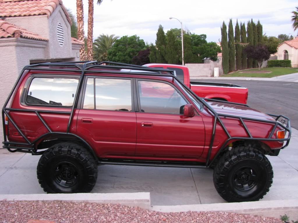

you mean this one. I love the way it follows the lines.

I really like this exocage too as it does follow the lines nicely. I think if I were to build it, the only thing I'd change would be to tie the rear portion by the window to the rear of the sliders. Other than that, I doubt anything would change...I also like the how it incorporates a roof rack. Anyone have any more pictures?

the problem with this is that you lose access to the rear doors
Not all together....You can bend or place the tube where ever you want and still maintain access. I just finished with an internal partial cage on mine and am not quite happy with how it turned out. It's just something I threw together a couple a days at work...still not finished with it though and I set all my projects up in phases...that way if I don't like something about, I change it.

From the wheel well or out side lip of the plastic faring to where it meets the door is about 1.5". Then there's the spacing between the door and the start of the plastic on the door it self. So there's plenty of room to do this and ample room if using 1.75" as the radius of the tubing wont even come close. Now this will differ depending on how far back the sliders go...that'll be the wiggle room as all sliders are not created equal.

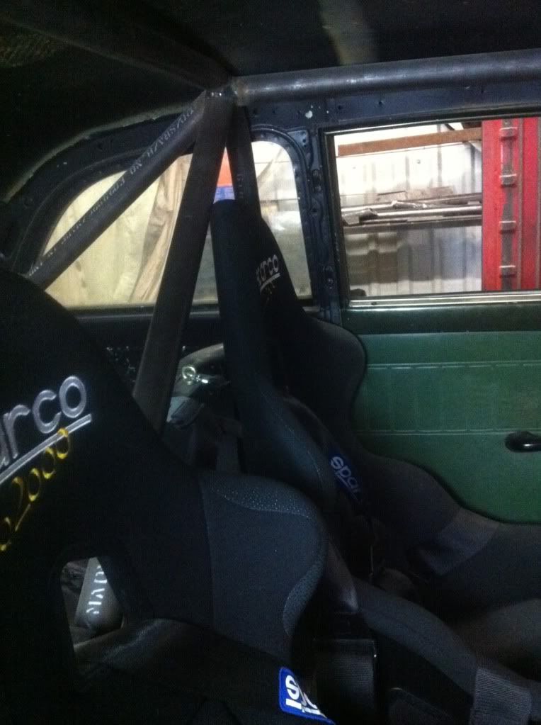

I've built a few cages too....a proper functional internal cage has no place in a daily driver. To have a cage, you must be harnessed no question. I have a cage in my little hotrod Volvo....it's SCCA legal, but I can't access the back seat, need harnesses and I built it REALLY tight.
In my opinion a tasteful minimalist exo cage like the white one above is ideal for a 3rd gen, I have a design in my head if I ever get around to building it.
This kinda shows how busy it gets:

This is my cage in my race truck getting tested last season:

Agreed...To take full advantage of a roll cage, one must build it completely and tie it into the frame. Then add in the 5-point harness. To further this, a full race helmet and the proper fire extinguisher or what ever the race circuit rules call for.
However, my deal is to be able to take my 4-year old wheeling with me. My wheeling style isn't extreme by any means and the partial cage is so that the wife (and mom of my 4yo) can rest easier knowing she's protected better. I've gone so far as to say she'd be wearing a helmet to protector her as well....but I feel that would be next to impossible on an all day trail run.
