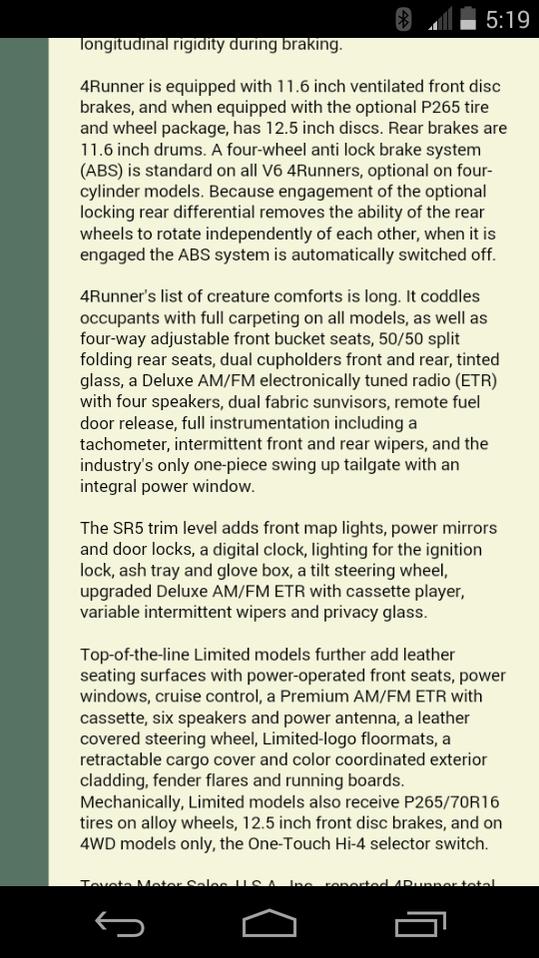

I don't think the limited has larger brake rotors. Primarily because the wheels are still restricted to 16 in. I'm trying find documentation to know for sure.

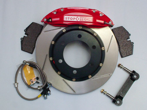

I can't recommend this enough. I did exactly as described (231mm upgrade with '06 Tundra calipers and factory pads/pins/retaining plates/etc; also upgraded to stainless steel brake lines from Wheeler's Off-Road) and am VERY happy with the results. After upgrading, the pedal provides 1.) initially a little more more bite, followed by 2.) more light and intermediate pedal control, followed by 3.) far more outright stopping power when called upon. I also serviced the rear drums shortly after the front and now it feels like Toyota probably should have done it in the first place IMHO.

My bad. The 16" wheel and tire option came with larger rotors only.

I did some research and found that the front rotors installed on the 3rd gen's were under sized so they warp really easily with stock equipment. I upgraded to a more performance type rotors & pads from AJ-USA Auto Imports. I got matching EBC parts from them and couldn't be happier.
I will admit I wish they would have told me these things come from the UK and it will take 2-3 weeks to get them. Oh well, once I got them installed I haven't had any more issues. I'm currently at over 10K miles on these and I have no warping so far.
EBC Sport Rotors (Dimpled & Slotted)
$220.87
EBC Upgrade SUV/Truck pad
$53.87
