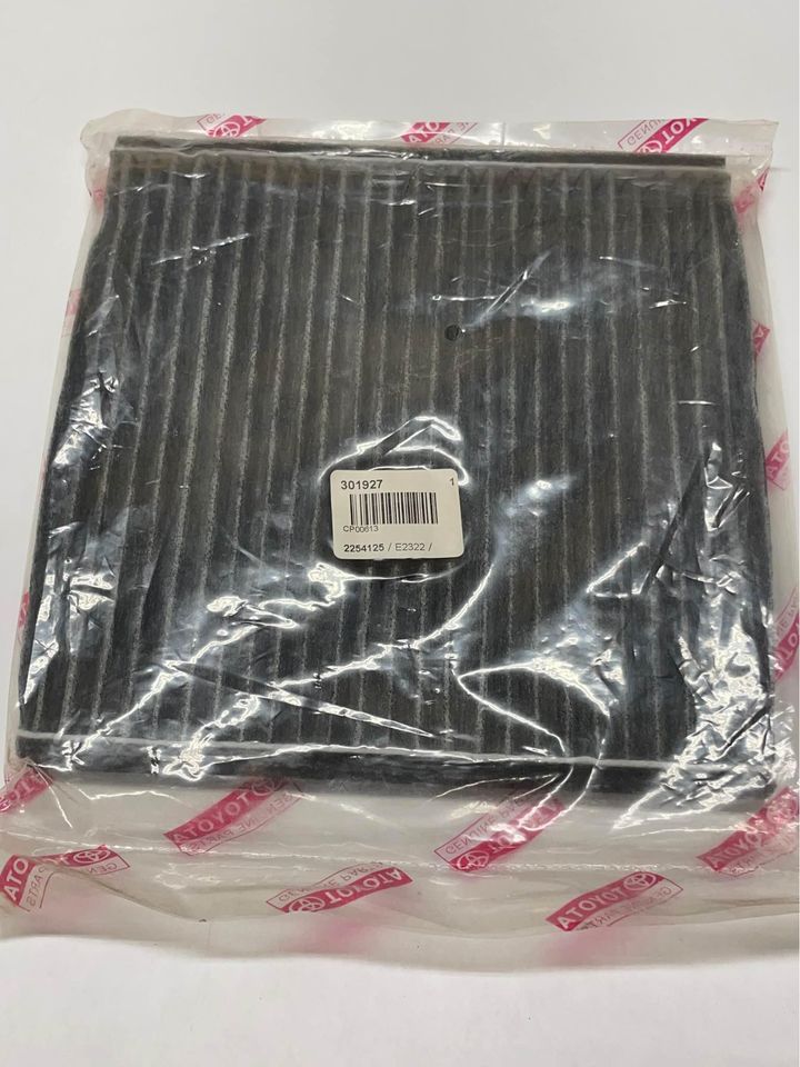

I actually bought one of the FB marketplace yesterday for 10$. Is it a relatively easy install? Any pros or cons in general about the air filter?
