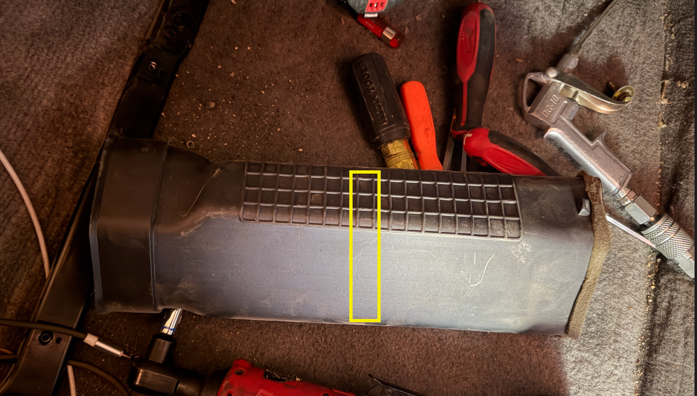

Had a little fun with foam filter media.
I had some UNI 60ppi (fine) stuff sitting around so I tried it out:
Also got some UNI 30ppi (coarse), which is obviously too coarse to be much more than a big ol' chunk filter
The two foams stacked up vs. the Merv4 media
I just focused on the airflow since they all had about the same sound
The fine foam worked about the same as the Merv4 stuff. The coarse foam actually provided noticeable more airflow but it not a very good filter. This could be a good compromise if someone doesn't really want dust/pollen filtration but just to keep out leaves and stuff.

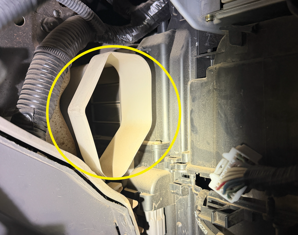

Ive cleaning my evap coil(lots of lint and carpet dust blocking) and thinking about all the filter stuff. We all seemed to focus on one that filters both intake and recycle air. Looking at the path the recycle side seems alot easier to filter.
What if we printed a sleeve and had a medium mesh filter on this part. It would be dead easy to clean vs removing the fan. Im going to try and print something up and see how it looks but id love to see someone with more skill than me try something.
disregard im dumb. I assumed that was intake but thats just the right vent plumbing. filter would do very little there.Back to the drawing board.
