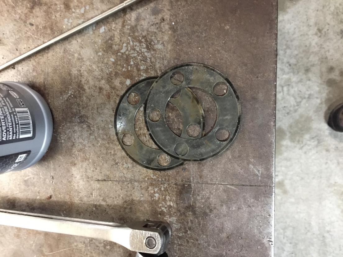

Well I ****ed up. I either did not get all of the instructions with my Spartan, or they just have piss poor ones. Anyway. Drove my rig to town today with locker installed. It was basically a spool. Started doing a little more research & found some instructions on Randy’s Ring & Pinion web sight that clued me into what is wrong. I left the side gear thrust washers in. There is not enough clearance for the rear to disengage. Anyway, I’ll get that pulled back apart & fixed tonight.
Got those thrust washers out from behind my side gears & my locker works as it should.
