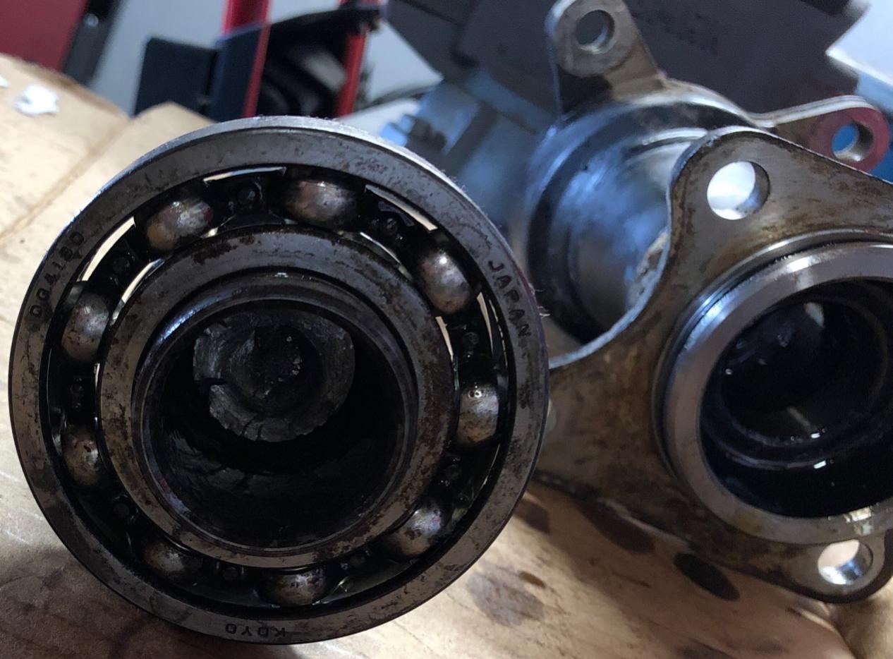

Have you been able to get the splined shaft out of the diff yet?
I've had that type of break before. I ended up getting a long drill bit from one of the tractor supply stores and a small slide hammer from Harbor Freight. The end of the slide hammer had 1/4x20 threads. So I used the long drill bit to drill into the piece of shaft that was stuck in the diff, tapped it with a 1/4x20 tap, then screwed the slide hammer into the shaft. A quick tap with the slide hammer pulled it right out. The shaft was surprisingly soft and easy to drill from what I remember.

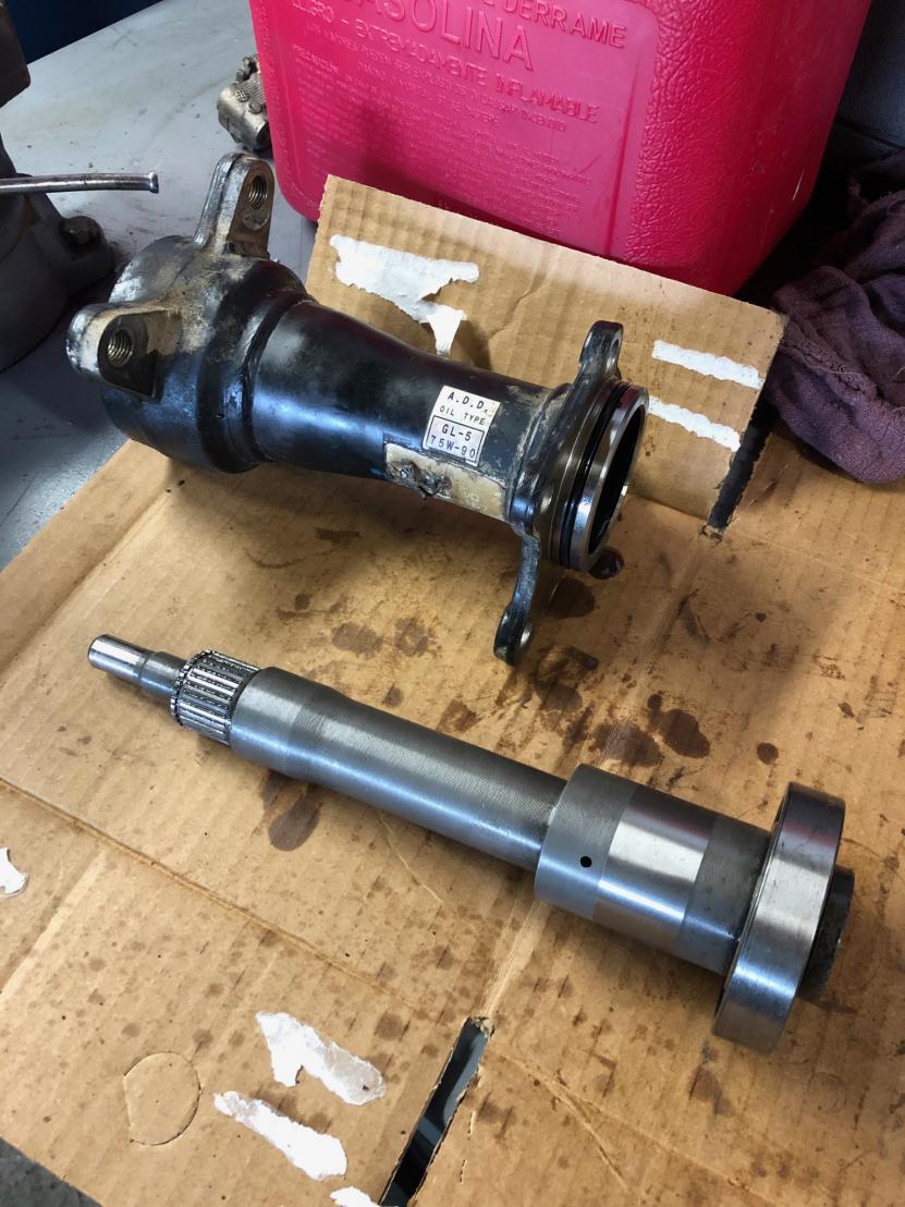

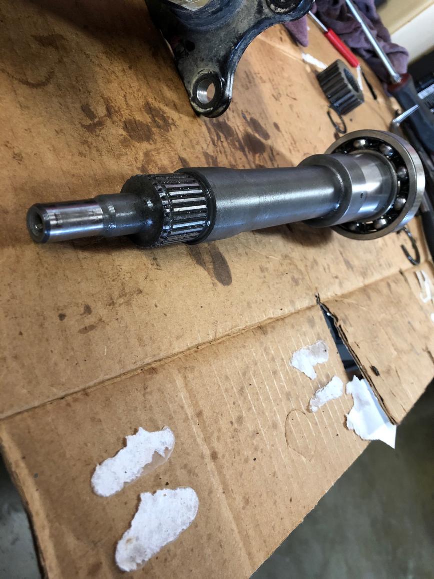

Ok, so I can not get the broken axle out of the shaft. new OEM axles and shaft with bearing and seal. Hopefully, this won't happen again.
