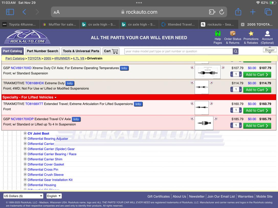

If I had to do it again I would do trakmotive cv axles. My cardone axle pop with normal turning. I may swap them out one day. For your V8 this is the model number TRAKMOTIVE TO8168XTT Extended Travel; Extreme Articulation
$160 each
$160 each
I would not do that. I have broken over 20 front aftermarket CV's in my 4th gen, I've tried every chinese brand and every parts store, they all break on the first rock when wheeling. I have a feeling the only good option is OEM and the chinese made versions are all the same, just in different color boxes.
