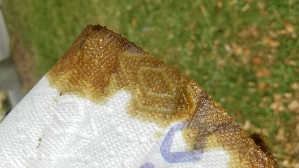

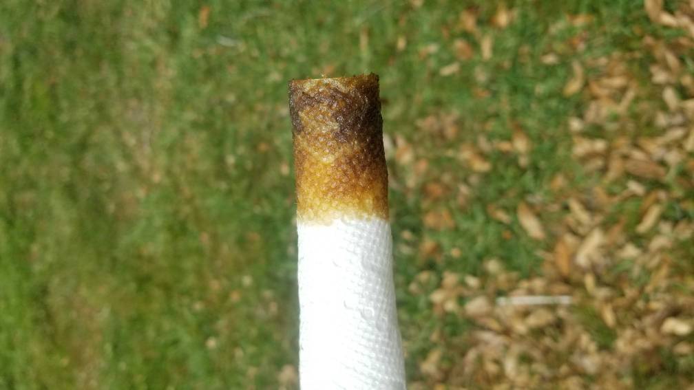

Yes they were just wiped from the lipsticks and you were right about the fluids. Here is a picture of me rolling the paper towel and letting it soak for a second
That's old Toyota Red mixed with Green.
Flush it and you are all good.

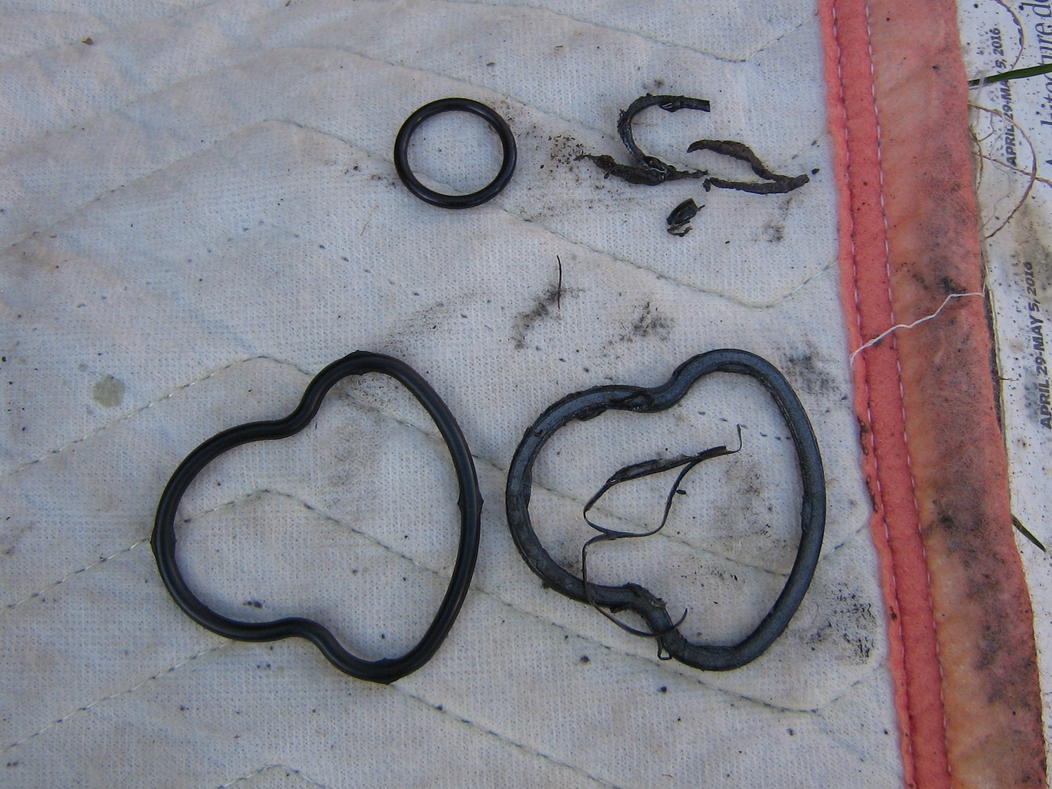

This is what oil in the coolant looks like:
-Charlie

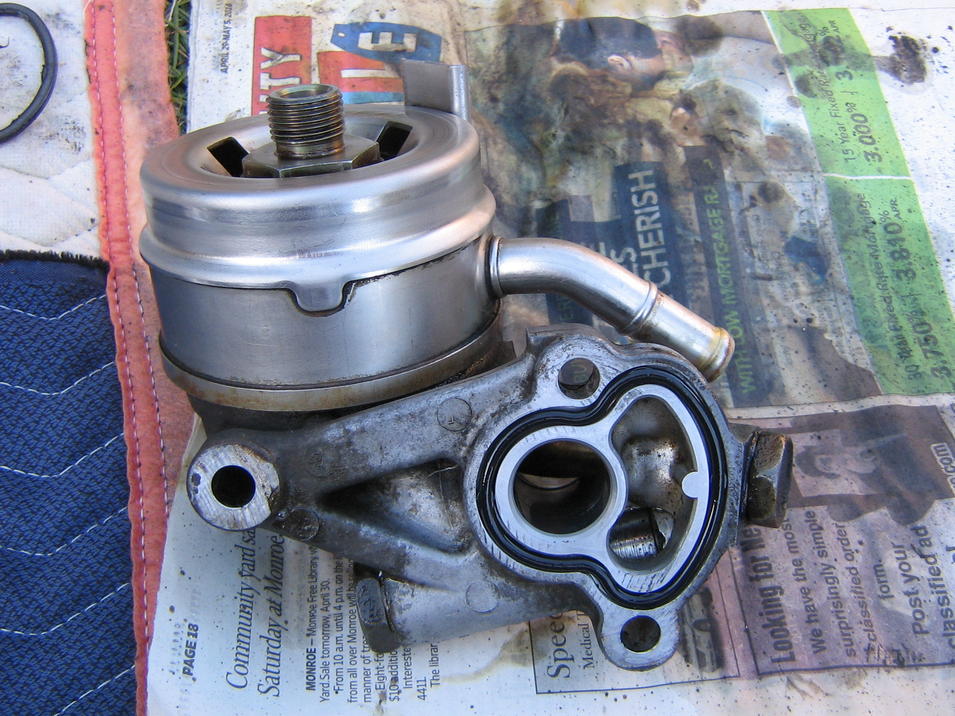

I dont know anything about the 5VZ oil cooler. Didn't even know they had one honestly because I never see them mentioned. The oil cooler on the 3RZ doesn't go bad but the O ring & gaskets do. If the 5VZ is the same it's a cheap fix. $4 O ring & $8 gasket. No need to replace the whole thing, there's no moving parts, it's just a pass through.
