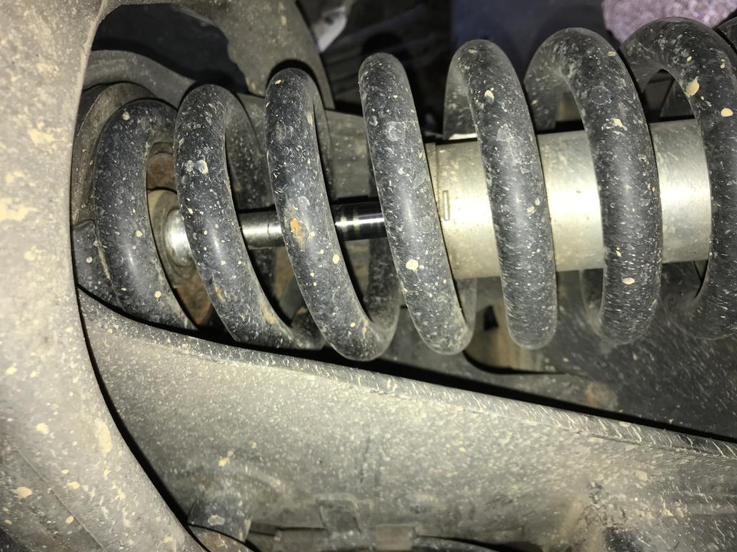

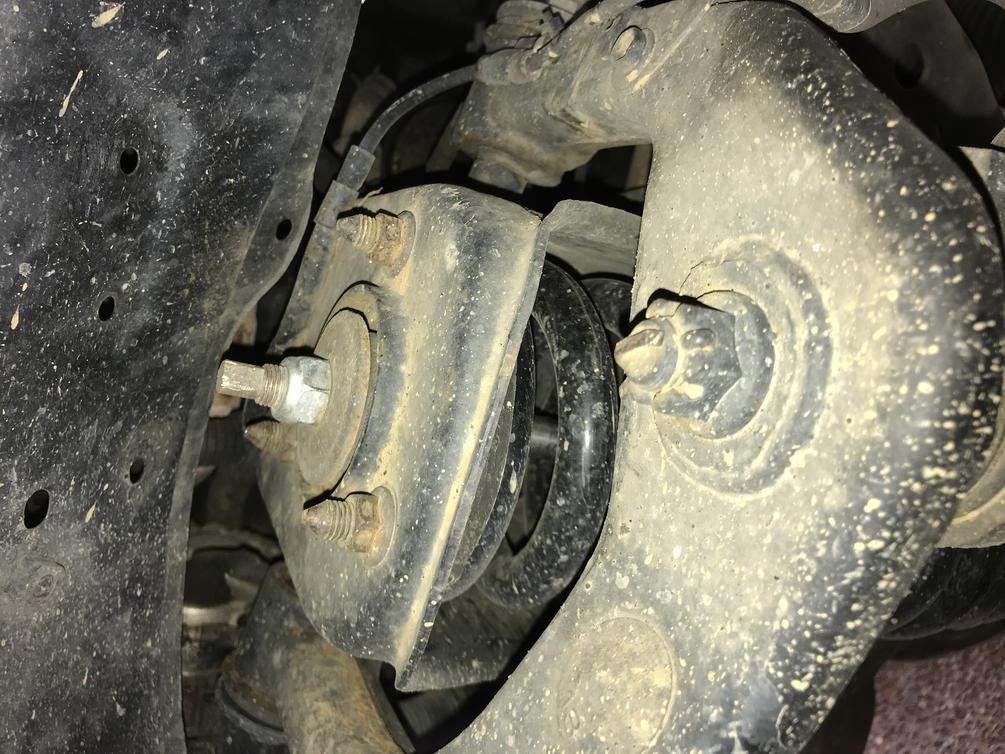

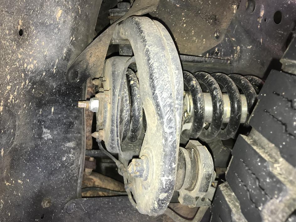

Front coils top pics below, yes the bottom of the coil is at the notch in the cupping of the struct. Measurements as well

Who assembled these units?
It is possible to have the lower perch flipped and still seat the spring.
Do both lower perchs look the same?
Both look the same and they were pre assembled
