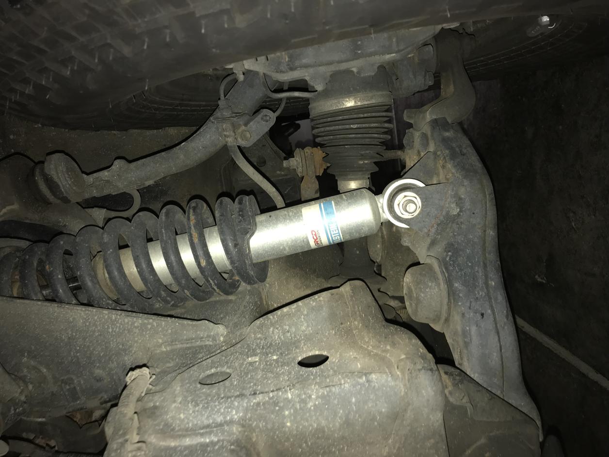

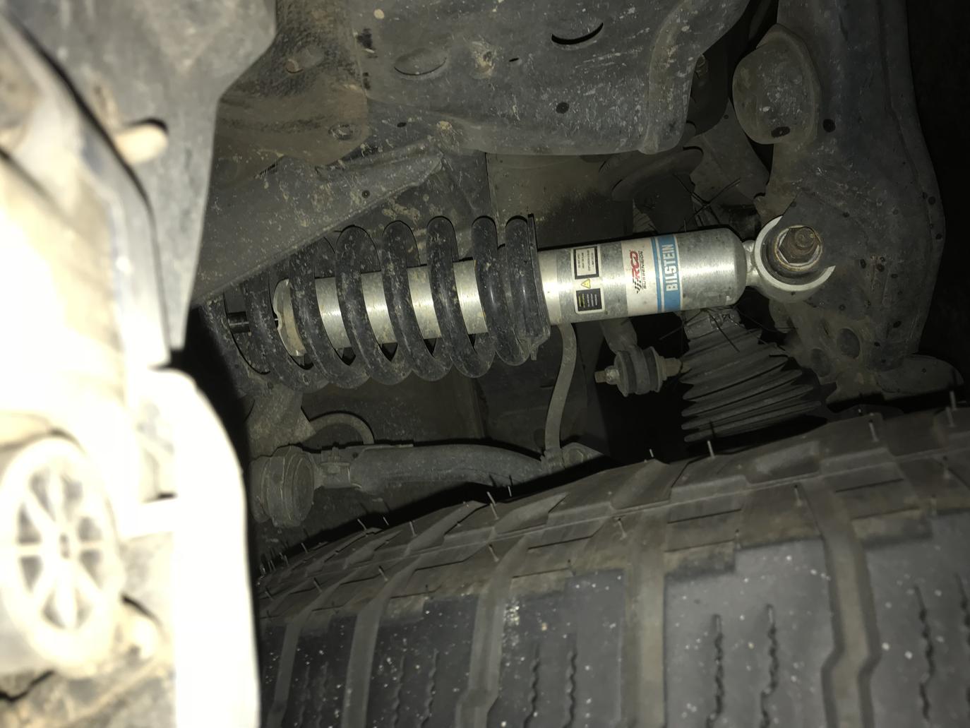

This is why I am confused, I thought replacing struct and spring with the same on both sides would make it level? Pics are from the front
You miss understood my post, SS1.2 & OME 3" are side specific, driver side is longer front and rear. Refer to post 20.
Your front pics show things are assembled correctly.
