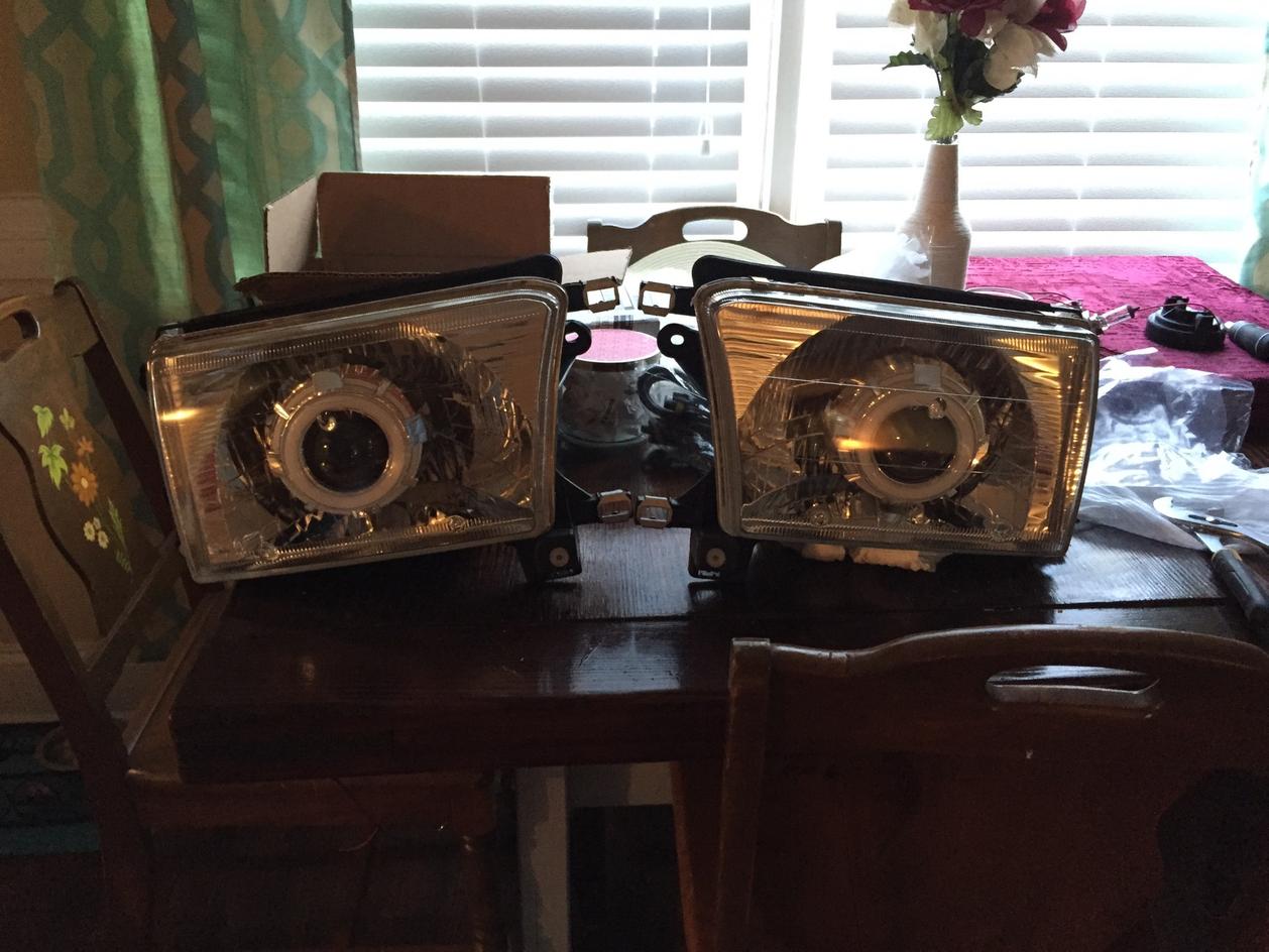

I have a set that I am working on now.
It will include:
Housings
Morimoto D2S v3
5500 Bulbs (best color)
White Halo
Gatling Shrouds
Everything painted graphite (color of my wheels)
Extended breather with filter to keep out the dust
Price: $675 plus shipping.
I won't be the cheapest but I think the end product will sell.
Completion ETA: 2-3 weeks (I'm a busy guy)

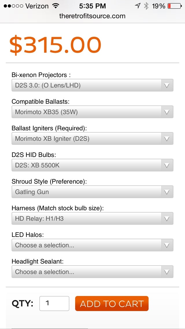

OP, you can do it yourself for just under $200. The new threaded bodies make retrofits an absolute piece of cake. You'll end up with perfectly level, 55w HID beams emitting roughly 5,000 lumens each! Now, this price also includes $20 LED or CFL halo rings. Although I don't think halos look at home on our trucks, they're still very easy to install and wire. Order all your parts through DDM and then order the halo bulbs through TRS. Text me @ 480.779.8307 when you need help.

It really isn't that hard as long as you DON'T get the FX-Rs.
Get the Mini D2S v3. You can see what they look like in MTDs thread and he says they are 95%+ same quality as FX-R.
If you don't paint it and you go with the easier to install kit you can do it yourself in < 4 hours plus another 45 minutes running the wiring harness.
It's really the painting that takes a bit of time. As far as the FX-Rs go ... I will never spend that kind of time again.

Okay could you send me a link. And is the cayman shrouds about the same as the gatling, or what do they look like. And is that all i would need other than the housings, halos, and paint?
