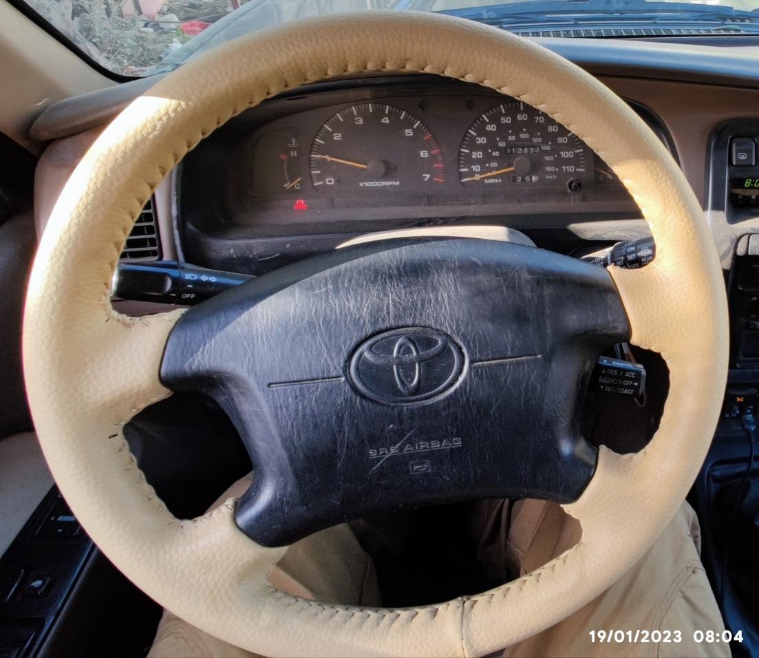

I've been getting mail about my recent steering wheel swap, so I'm gonna give some info.
Upgraded wheel is from a 2000 Lexus ES300. At 1st I only bought the steering wheel and tried to fit my stock Toyota airbag into it. No go! So I went back to get the Lexus airbag. Fit perfect!
This swap is a PNP! The airbag and the horn/cruise control plug bolts right in. The Lexus wheel had 2 extra wires that is used for something, so I removed it because the Toyota only has 4 wires total.
The only thing I did was read some write ups on steps to remove the steering wheel right here on this site.
I hope this helps for the future guys that want to tackle this upgrade. Keeping mind that Camrys, ES300s are the same and can be used as donors.
