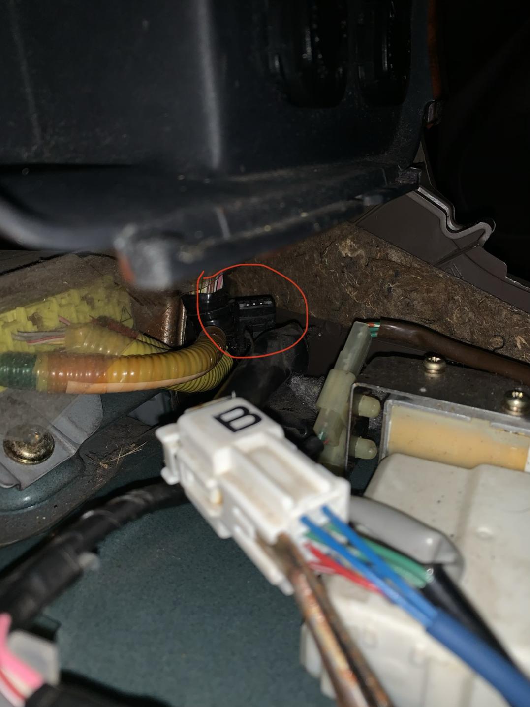

Brand new to the forums and I just bought my first 2000 4Runner 2WD. I’m trying to learn how to repair my own cars and I’m starting with my new 4Runner.
The the airbag/seatbelt/SRS light is flashing on the dash. I’ve read the codes and it’s reading B0131 and B0136. I’ve scoured the internet for advise and everything keeps saying to check the pretensioner but all the videos and posts online show a yellow connector below the seats but there’s only one main white connector that I’ve reseated and hasn’t done anything.
Can anyone point me in the direction of where the pretensioner connector is because I highly believe that both left and right pretensioner issues are related.

Have you pulled the plastic trim pieces off the B-pillars to investigate? The seatbelt tensioners will be in the B-pillar right under the area where the seatbelt spools out from. The trim pieces will pull right off. In the video below, go to play time 21:15 and you can see how we first get the plastic trim piece off near the rear door and then we pry off the B-pillar plastic trim. You would also want to first remove the trim piece near the driver side door entry as well before removing the B-pillar piece.
How exactly do I go about investigating and troubleshooting? To my knowledge, the car has never been in an accident and there has been no reason for the pretensioner to fire off.
I just removed the b pillar to look at seatbelt and tensioner. Everything appears to be in order from what I can tell.
Edit: I’m also wondering that since I’m getting the same code for both sides, if it’s an issue with the airbag assembly module. The previous owner did have a deck installed and I’m wondering if maybe some connectors weren’t reconnected after installing.
The fact that both pretensioner codes are going off at the same time is weird. I've never tested out a pretensioner before so I don't know the steps to see if module is fine. I don't think the installation of a stereo would mess with wiring for the air bag. The air bag connector is under the steering wheel column behind a plastic trim piece. In the video below, you'll see it at play time 21:45.
I did some research on this problem and there seems to be minimal information on how you can diagnose what's wrong.
I took some pictures from my factory service manual regarding the steps to test the pre-tensioners. Fair warning it's a little hard to understand exactly what you need to do. Send me an email, and I'll send you the photos: [email protected]
Pulled off steering wheel attachments. Didn’t appear that anyone had ever worked on the steering wheel before. I’ve reseated all the connectors.
Pulled off the trim and was looking at the airbag assembly module and saw that this was not connected to anything. Does anyone know what this is and where it connects to? I didn't see anywhere to connect it to.
