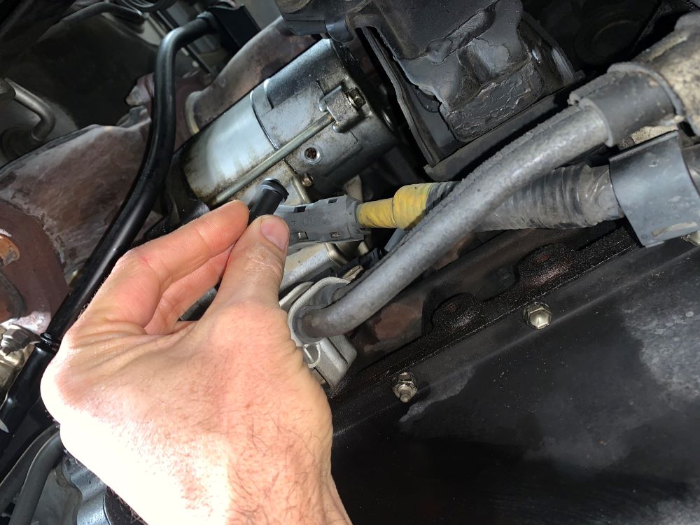

What is this part?
what is this part?
This little black plastic thing broke out...important?
also seems to be leaking a bit of oil?
what is this part?
That's a breather for the starter motor. What it's purpose is, I'm not 100% sure. I'm guessing it's to give some air flow so moisture doesn't build up inside. The starter motor only runs for a very short time so I doubt it's to let pressure escape that builds up from the heat that's generated but I could be wrong.
what is this part?
If it is the black plastic thing that attaches to the starter, I recently broke mine too when I was replacing my transmission. If I remember correctly I think there are 2 of them attached to the starter. I super glued it back on. Haven't checked to see if it stayed glued on.
