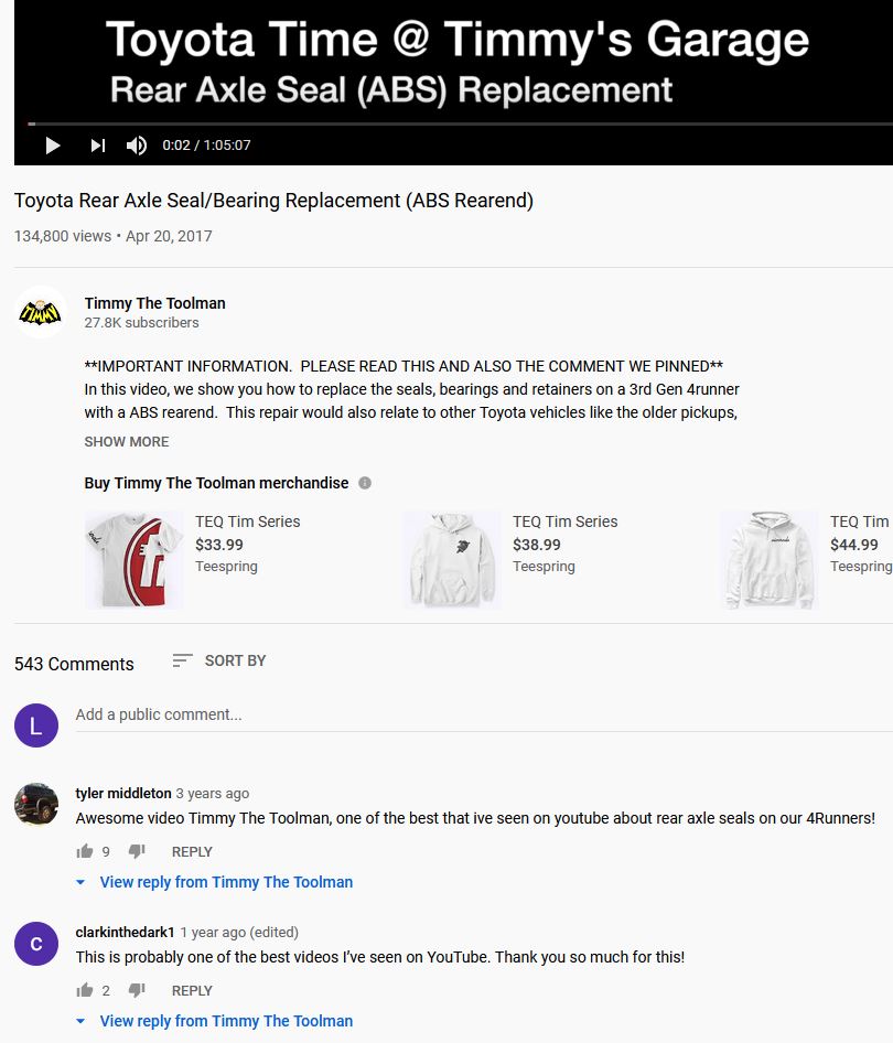

Hey Tim, I'm probably an idiot, but I'm not seeing a pinned comment for the ABS video regarding reusing the retainers and skid control rings. Am I missing something, or is there no such pinned comment?
I just checked and the comment I pinned is there. My comment should be the first one you see as you scroll down under the video description.
Maybe there's something weird with Youtube for me, because this is what I see. Any chance you could paste the comment here as a reply?
Nevermind, I found it by scrolling through the comments. Not sure why it isn't pinned to the top for me. Pasting it here in case anyone else is having the same issue:
