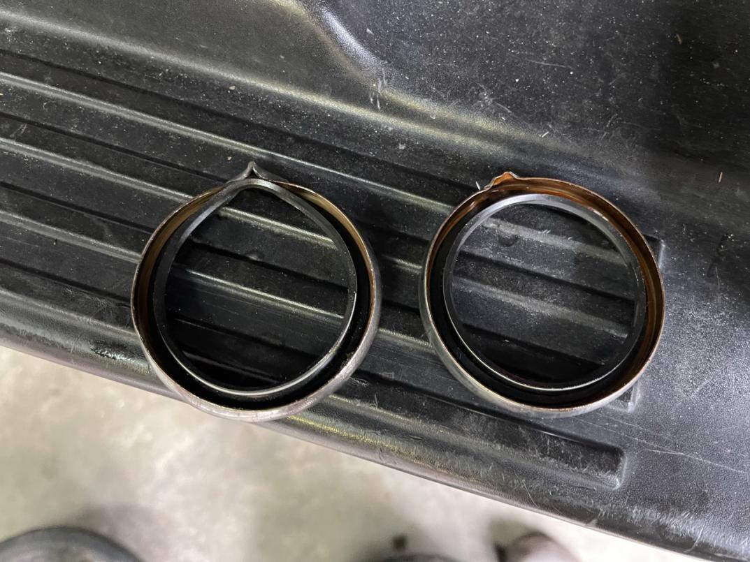

So I tried to follow along with the video to install the new seals, but they got hung up on the hole for the ABS sensor. I also had to hammer the seals in from the start, and in the video it looks as if he pushes the seal in by hand past the ABS hole and only does a little hammering past the hole.
It sounds like you got the wrong seals.
