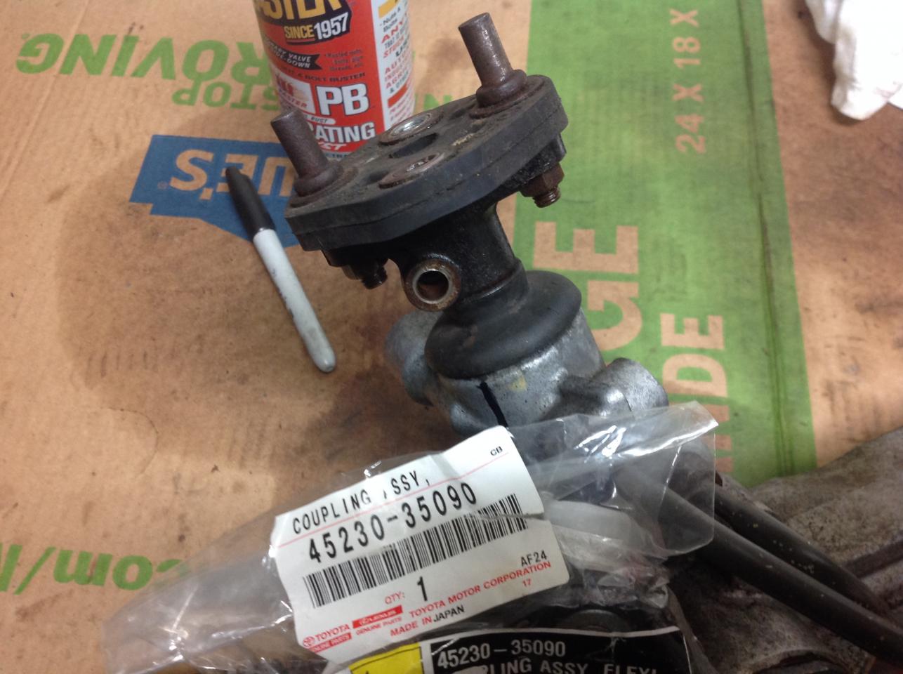

That one part !
That hasn't moved since leaving factory 21 yrs ago.
Parts sites don't break it down dealer parts counter didn't know.
Pic is what you get with this part number is ideal when only needing rack
half of rag joint.
