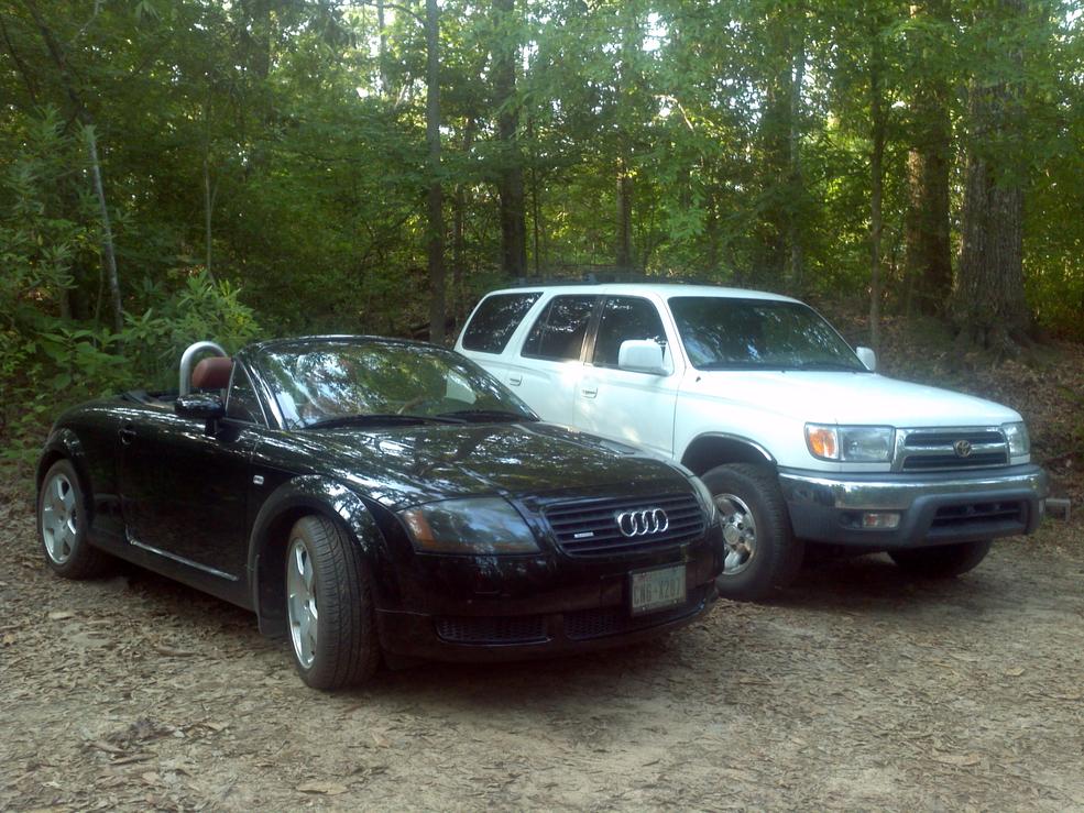

I don't know about the German theme? Strictly speaking anyways as some Audi's were built in Hungary. But I'm game; I'll call your convertible and raise you Quattro.
