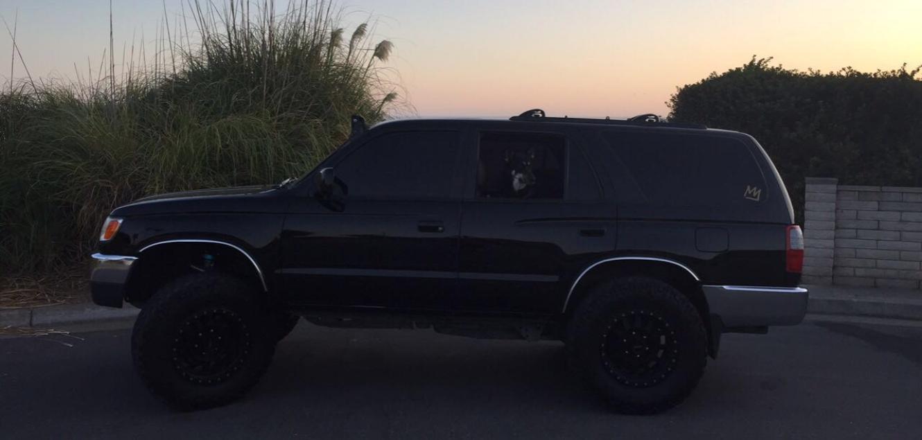

Yeah it sits level. I’m wondering if I could leave the diff drop kit and just change out the front struts, springs and remove that ball joint extension? Thinking of using Bilstein 5100 and OME springs the whole away around.
My opinion, call Procomp, because that looks to be their kit. The coil spacer looks stupid but this kit actually looks to be well thought-out. Adding a longer coil setup would increase the ride height and you'd be back at square one with altered ball joint and CV angles. I think this kit is meant to travel exactly like factory, with the difference that it clears larger tires. My guess is that any stock replacement length shock with factory coils(or the lightest duty OME if you install a bumper) would be ideal. The rear doesn't seem as tricky.

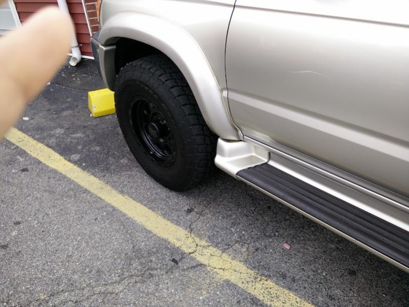

How do you like those? Considering getting 265 terra Grapplers for mine, how do they drive on freeway? Also do you have any more pics with those tires? Thanks

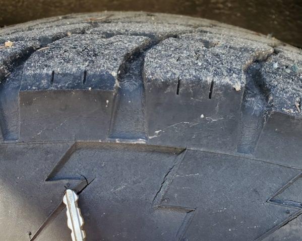

Longevity: The tire was made in 2015 and I bought them used from a guy on the internet in 2017. So they are old and there is some cracking on the sidewalls, but the tread is still good.
Comfort: Seems quieter and less balancing issues than the KO2s. About as comfortable as any all-season, but a little more noise.
Handling: Dry and wet is about as good as any other tire I've used. Ok in snow and ice.
Durability: No flats. Drove them over sharp rocks on Denali Hwy.
Summary: I like them and would buy again. I actually like them better than the newer KO2s. I spent over $1000 on KO2s and got rid of them after 2 years because they sucked. It's an old design though, the Terra Grappler G2 is the newer version.
