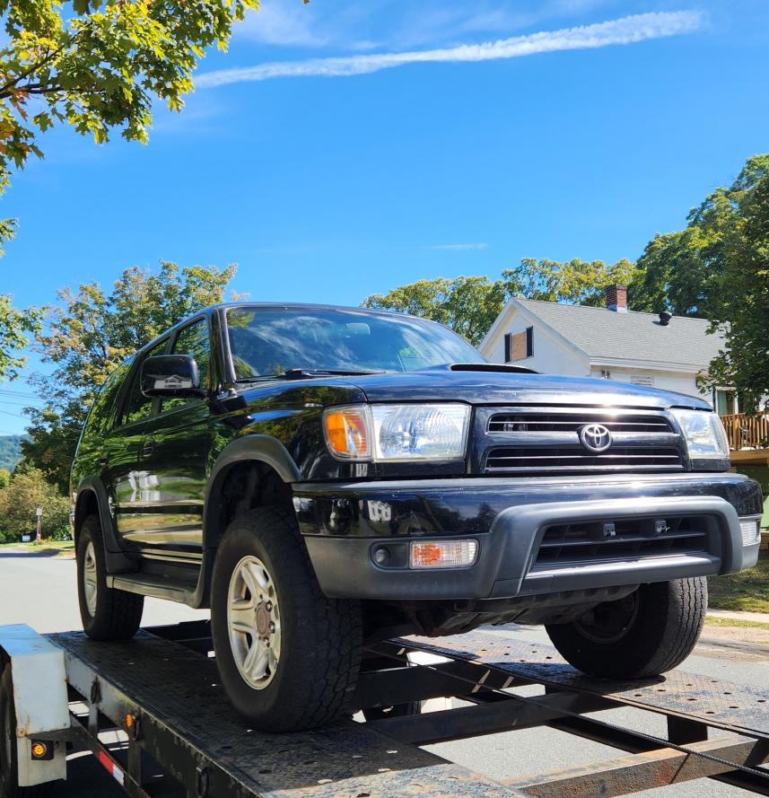

Welp, I'm the proud new owner of a '99 SR5 in need of a laundry list of parts, but the body and interior are in great shape! Plus cold AC, hot heat, cruise all works. Got it trailered to my house yesterday. The project begins...

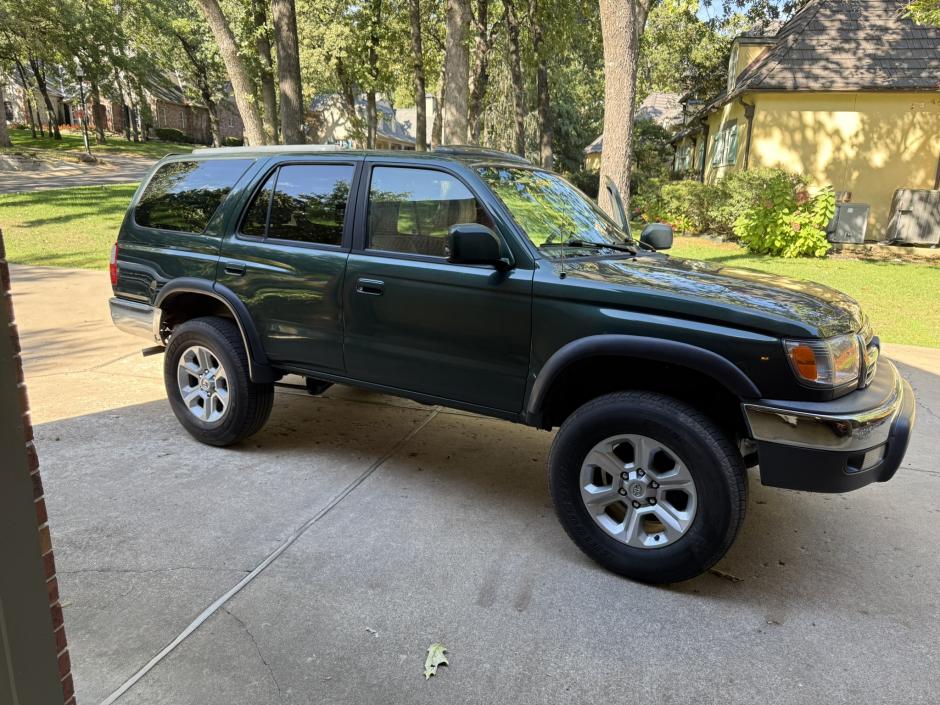

2000 4X4 SR5 Sport with rear lock. Been lurking forever finally got a chance to make an account.
Also have manual windows and the driver side is giving out any one have recommendations on a used or new replica?
cant seem to find it anywhere online.
Also my rear window is broken thats actually automatic. Anyone have a how to video for that?
Thanks!

2000 4X4 SR5 Sport with rear lock. Been lurking forever finally got a chance to make an account....
First of all, welcome.
When I purchased my 4Runner it had manual windows installed by the previous owner, meaning that it had come from the factory with electric windows. It also did not have a functioning rear window, though the motor, regulator, and other internals all looked fine. I am not a fan of crank windows so it was the first thing I changed after buying it. All of the wiring harnesses were still present and when I plugged in the master (driver's side) window switch to test it I was able to operate the rear window. So on my '99 with factory electric windows you need to have the master window switch plugged in to operate the rear window.
If yours also originally came with electric windows I would bet that is the reason your window doesn't go down. I'm curious how it works for 4Runners that came from the factory with manual windows because as far as I'm aware they still have operable rear windows. You can make a thread about the issue so others can chime in too.
Good luck with your troubleshooting.

Thanks ill try the search tool.
Looks like mine was just factory manual. Which idk how many they made, I didnt see any electricals so thats why i assume
I need to search how to fix that rear auto window gets stuck and my moon roof is toasted which i dont use anyways
Ideally I'd want manual cranks for the drivers window and electric everything else. So you can still control all from the drivers seat. And if you end up in a lake and the electrical system dies you can still roll down your window. Hey, if you need to get rid of your old manual cranks... lemme know.
Yeah, manual window 4Runners still got a power rear window. Oh, and power mirrors (control on the dash instead of the door control).
Check for window operation with the key in the rear keyhole (turn and hold each direction). Any number of places can have an issue, so this is just a process of debugging.

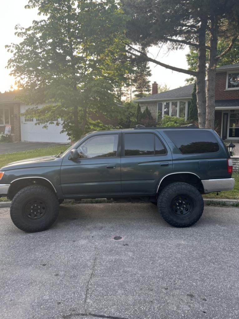

Bought a 1996 3rd gen in evergreen pearl earlier this year with 245,000km (150,000 miles). The journey begins!
Good looking truck! Love the black wheels :) though, those tires look a little too big and that you'll be rubbing fenders a lot...lol

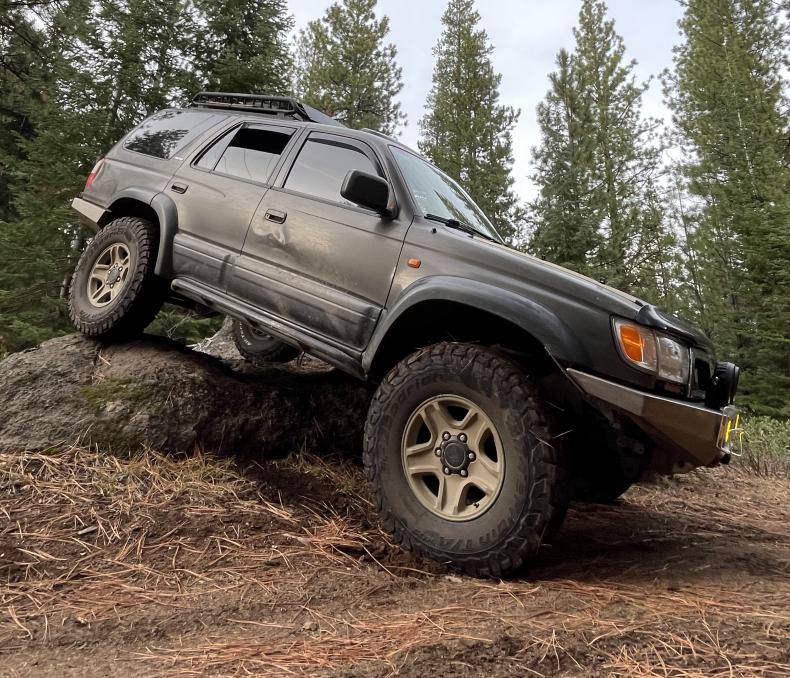

Just joined the forum. This is my 3rd gen T4R, 2000, SR5, 5MT, 4WD. It's been a huge project, bought the car on BaT around a year ago and it had way more rust than I anticipated. I had to do a full frame swap after the passenger rear lower control arm mount broke off while I was driving :wow:. But now it has a powder coated frame, all new OEM front suspension, highlander springs and Bilstein 5100s among many other new OEM parts.
