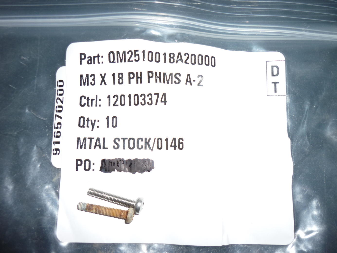

There have been a few threads on here with respect to the fog light screws on a 3rd Gen T4R. I have found the perfect solution. I purchased these Phillips head screws (Stainless Steel) from Fastenal. I think they were 7 cents a piece. I have attached a photo with the part number which is: QM2510018A20000 and the description is M3 x 18 PH PHMS A-2. You might be able to order them online from Fastenal or go by a local store. I have used these and they are PERFECT! Hope this helps anyone looking for these screws!

I worked at Fastenal for some time and I know they can order just a few pieces if you need them. If they give you any hassle on it, ask them for their District Manager's phone number and email. I can assure you that when you do that, they will sell you just one piece if you like. Better yet, go online and see if you can order them there. I just looked and they are .053 cents a piece! Good luck!!!
Good info. I am about to replace my fog light bulbs, and I figured I might as well get these while I'm at it. Went to the Fastenal website and put six in my cart, but they want almost $10 to ship them UPS. Went by my local Fastenal location, and the guy was very willing to work with me on it. He said the minimum he could order was 10.
Got the screws from my local Fastenal yesterday and replaced the originals with them after I put new bulbs in today. You're correct, they are perfect and much, much better than the stock screws. Thanks for the info BamaDrewski.
You can also find similar screws from Ace Hardware. I went to my local store for my foglight's hardware replacements.

Thanks, 4 out of 6 of my screws melted as soon as I took a screwdriver to them lol
mcmaster-carr probably has the equivalent parts too. Same day cheap shipping if you are in the Los Angeles area.
I've ordered stainless hardware (or ultra-high-strength stuff, depending on application) for multiple car projects. Most recently, all new aftermarket skidplate hardware.
