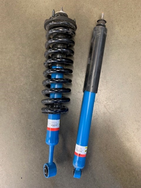

3rd Gen Taco shocks on 4th Gen 4R
So I've been reading this thread and there is a ton of good info here - thanks to all that have contributed, especially Bluesky 07.
I've come across a set of very little used 2022 Tacoma TRD Sport /front coilovers and rear shocks - Toyota/Hitachi labeled, not Bilstein. I have a 2003 4Runner Sport that's just about to hit 300k on the ODO that we bought new which my wife drove forever, then I did for a while, followed by my daughter, and now it my son's turn. Of course it's the rake that he can't stand, and I agree it needs to go, but I'm not looking to spend a lot on this rig at this point.
So my question is, can I simply remove the X-REAS shocks and put these Tacoma Sport shocks on to get similar results as many of you have?
