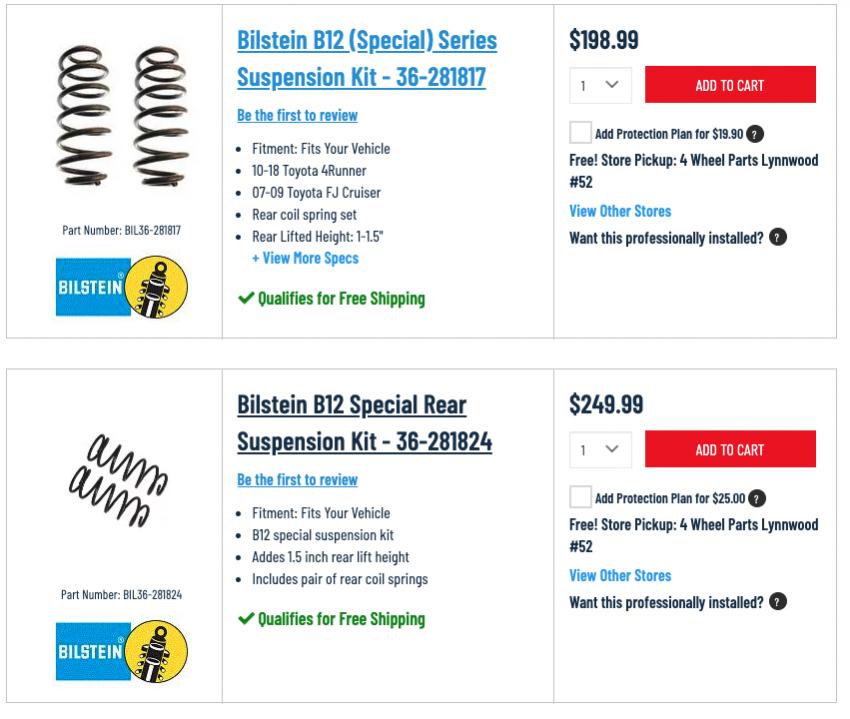

Thanks for all the info here! Which B12 rear coils did you use? I've found 2 different sets with similar names:
Bilstein B12 (Special) Series Suspension Kit - 36-281817 - $198
Bilstein B12 Special Rear Suspension Kit - 36-281824 - $249
Also, with the lift you got, did you need to do anything with your UCAs?
