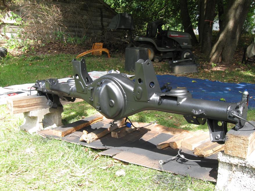

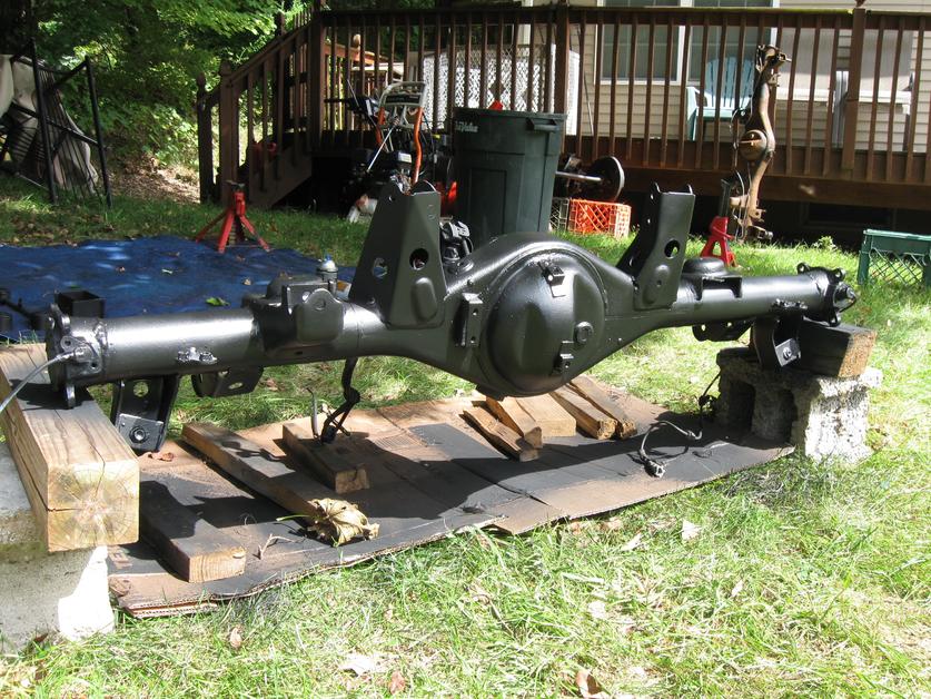

Maybe the POR15 dries smoother than the Eastwood. I tried foam brushes & different poly brushes. I know it's under the truck but when I see other people's hack jobs it bothers me. Especially on the axle housing, some people's paint jobs look terribly bumpy with the glossy finish over rust. With my 8 wraps you can see my axle housing clearly from behind & I want it to look better than stock. I think it came out nice.

I got my axle sand blasted. Then used chassis saver in a spray gun :) only used brush under the body in tight areas.

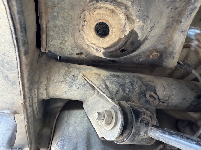

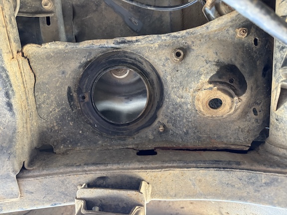

I have a similar problem on my '98 limited with 440k miles. I was hearing some knocking in rear drivers side wheel well and though it was just a worn shock bushing. If only I was so lucky. After a closer inspection I found that the entire mount is pulling away from the body. The welds on top of the round crossmember had popped loose which caused appears to have caused the mount shift and tear the frame at the weld joint and crack the mount itself in the rear. I haven't been able to find a local auto body shop or welder that said they do this kind of work. Does this look repairable or does this need to be cut out and replaced with a new mount? The metal on the mount itself is in good shape rust wise. Someone suggested that I take it to a muffler shop to do the welds. Just wondering how I can get this fixed. I've done some minor hobby welding with my Lincoln 140 MIG welder but this seems far more substantial. Thanks in advance for any assistance.

How I fixed it on one of mine was to replace the inner rail and beef it up then cut a hole in the body to get the front to bolt a plate down. Once you get it solid again you have to beef up the welds. I also slid a pipe into the tube cross member to give you something to weld with. You can see one way of doing it by going through my build thread. I wouldn't replace it. I would just get it to stay in place. Kinda harder to do with a 110 mig welder but it can be done. A 220 mig welder will do well for that project as it gets hotter. If it get thin around the shocks You can weld plates on the outside of the frame and outboard those.. :-)
