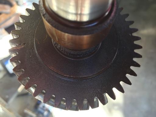

The exhaust cam can be removed to change the shims. However, if you chose to remove the exhaust cam make sure you put one of the valve cover bolts in the service hole of the cam gear, and line up the correct dots on the cam gears before removing to ensure there isn’t any spring tension on the cam lobes.

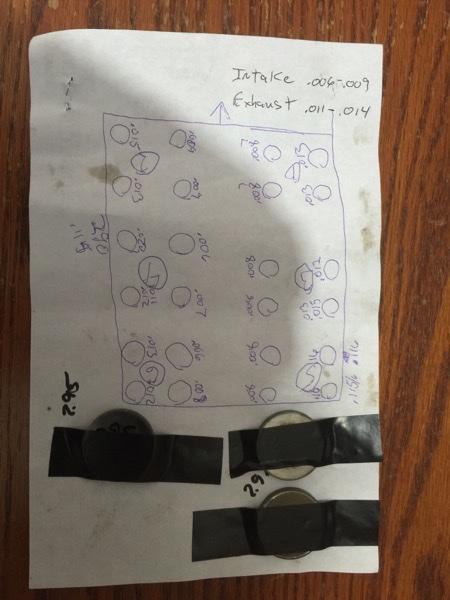

How I keep track of my work

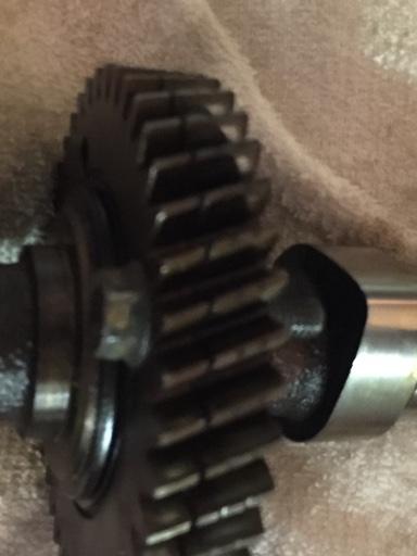

If you have multiple shims under the exhaust cam that need to be replaced, it is easier to pull that cam since it doesn't have a chain like the intake. A few notes about removing camshafts:
1. Remove the caps in an X shape working from inside out to balance the clamping force on the cam shaft, it is not a flexible piece of metal. Make sure a valve cover bolt has been threaded through the scissor gear before removing. Have the engine at TDC too.
2. This also applies to reinstallation, tighten it down using the correct order (reverse order of removal I believe). I worked my way up to the torque spec.
3. The cam caps have labels with arrows pointing forward, they must be put back in the same orientation and location.
4. Another note about these camshaft caps, despite their mundane appearance each cam cap is the only one in existence that can work in its place. If you break one, your head is now junk because you can't swap that part off another engine. So treat them with care.
5. If you do want to remove the cam, another required tool is a torque wrench. They don't require much torque, so get a 1/4 inch torque wrench is what you need

Here is the worksheet I used.
Be prepared to curse a lot.
