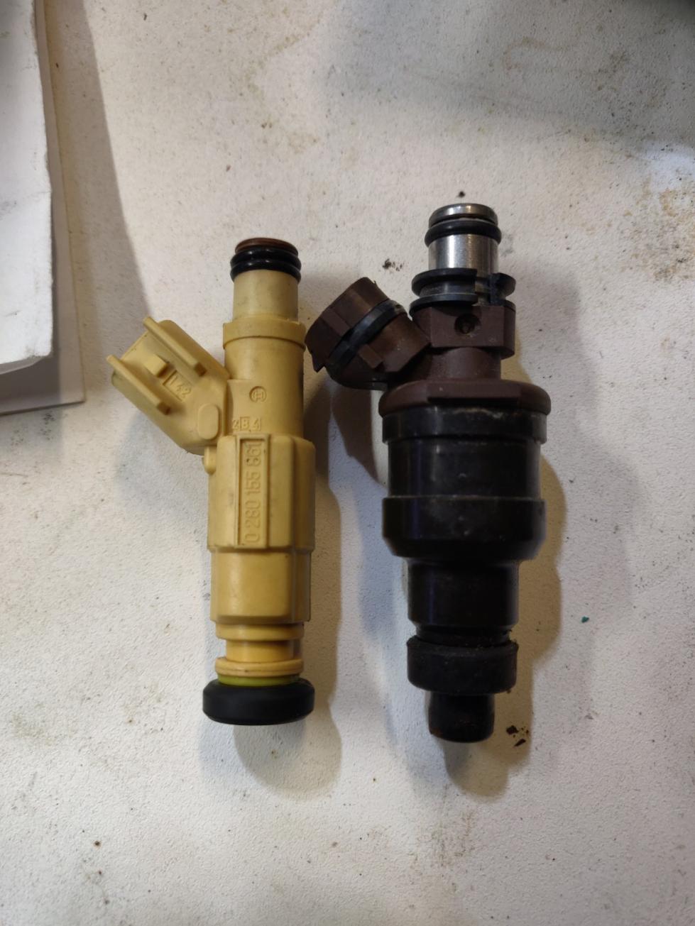

I ordered some Bosch 4 hole injectors (rebuilt) off Ebay. Seller insists they are correct for 89-95 3VZE. they look simialr to other images of the bosch 4 hole i have seen, but they look NOTHING like the injectors i pulled out and dont fit into the injector cups and are shorter that the ones taken out.
The BOSCH are the tan/yellow ones...
Am I looking at a comparable part that will fit?
