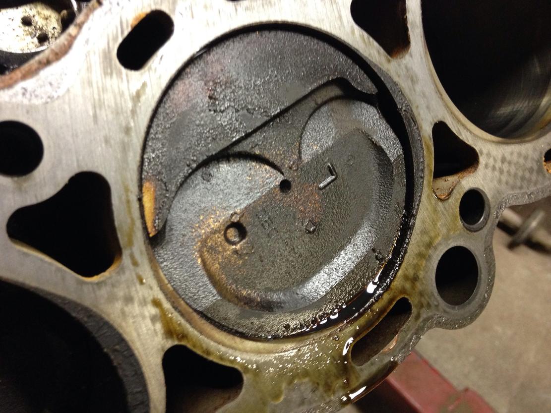

So I'm rebuilding my freshly rebuilt 3VZE which didn't even have 1,000 miles before it grenaded on me. Long story short, I purchased this engine from PMC motors in Oregon and after this happened they stopped communicating with us even though it had a 7 year/70,000 mile warranty costing me over $3,300 so I'm rebuilding it myself now. Anyhow, the engine was claimed to be bored .030 over, but after I took it apart I found the pistons are stamped with .050, shows how much they actually know about their engines. I also found that 2 rod bearings were smashed on the ends indicating they were put in wrong, all the cylinders have scrape markes and one piston had oil on top of it indicating the rings were too tight, all the thrust washers look like they've been filed and ground down, all the rod bearings are scratched up, and one rod bearing set was misaligned so the oil holes weren't lined up causing oil starvation and totally chewed up one of my crank pins. Sounds like a quality rebuild on their part, right? Anyway, I'd like to go ahead and bore it to .060 since I've got it all apart, but my question is where should I get new oversized pistons and rings? I've done a little searching and come up with nothing so far, but I'll continue to look. Also, if there's anything anyone recommends doing while I'm rebuilding this feel free to throw out suggestions, I'd much appreciate it

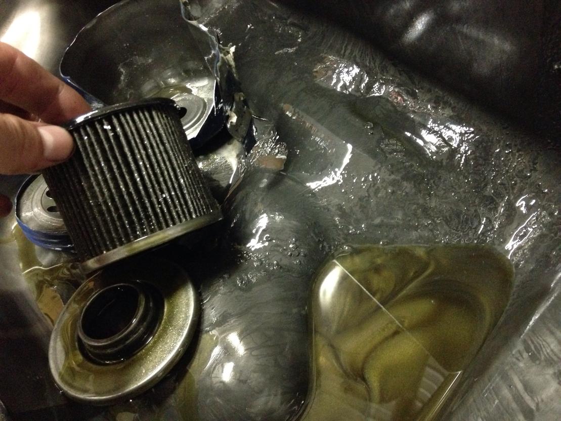

the copper colored oil from the filter and the sludge/chunks of metal that was in the oil pan after drained
