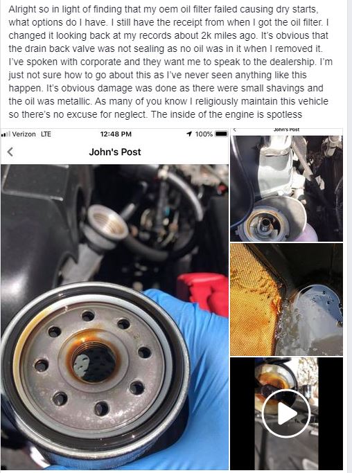

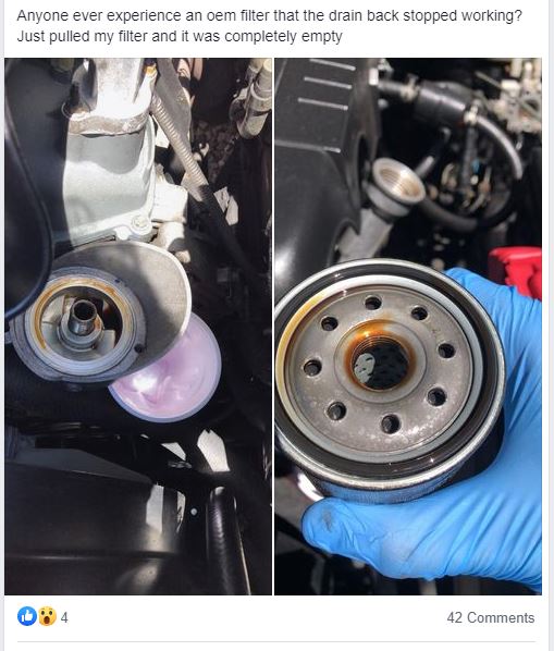

Thats good that you keep up with the changes. The other case I was referencing was actual an OEM Toyota Filter purchased at a physical dealer IIRC, let me see if I can find it. In my option, they're one of the better filter options and I use them myself. It sucks, but things happen, and it might have a bad anti-drainback valve. The tell tale is removing the filter, and if it doesn't spill a filter full of oil out, the anti-drainback valve within the filter is bad.
Looks like the post is from Facebook and not sharable, but I can PM you where to find it if you want to read the comments and stuff
This is interesting . . . so far I have gone with Toyota filters and they seem pretty good. I might have to look into a remote oil filter solution as the miles climb on the 1GR-FE.
I have been using the Toyota filters myself also and have been satisfied. At $4-$5 a filter, they're certainly a great value. Unfortunately I think crap just happens that caused that one to have an ADBV failure. This is the only OEM Toyota filter failure I've heard of.
