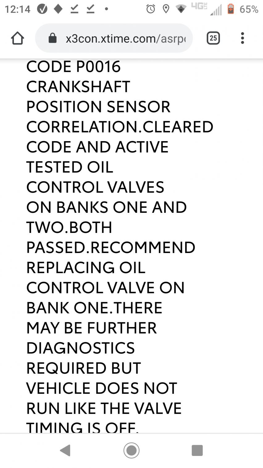

I purchased an 07' last Monday, fluids being changed and drive belt being changed as we speak...got a call...got this OCV code. I've done some things on a car and my 77' cb750f super sport but never with an engine. How much mechanical experience did you have when you did this? Any special tools you need and is it easy. I'm not worried about time. Thanks.
This is what I've been sent.

Don't waste your time replacing the oil control valves. If they were faulty, you would have a different code.
The first thing you need to check when you have a P0016 code is the timing chain tensioner. On the front of the timing chain cover is a rectangular plate secured with 4 bolts. This is the inspection cover, remove it and see how far the tensioner has extended. If you can see lots of shiny shaft and several 'oil bands', then your chain has stretched.

Awesome, thanks. The truck runs great, pulls great no hesitation in throttle response, idk if any of those are signs of a stretched chain. I also don't want to think this but am hoping that a dealership is trying to compile more and more things wrong with the car than actually are due to the state of the world. Also can't believe they quote you $70 to change the license plate bulbs but I got bigger problems than that.

Awesome thanks everyone. Also, the only reason this came up was because on my way to dropping the car off at Toyota last night my dash lights lit up. Engine traction vsc off and the other one. I read that it could just be the gas cap, had them scan for the check engine and they said it was the OCV. So idk if it's the gas cap, Ocv or potential timing chain. I'm not paying for any of it today so just trying to figure what everyone thinks my next step should be.
Got back from the dealer, the gentleman inspected the timing chain and said everything looked good. They also said both #1 & #2 OCV's looked good, but he recommended changing #1. Just odd. Thankful for the chain being fine. Thanks everyone.
