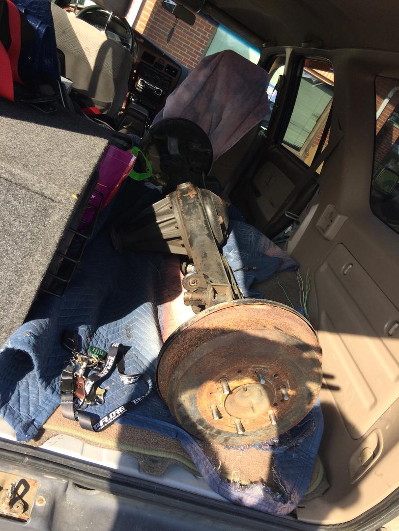

I am seeing the seller tomorrow to inspect the housing and elocker. I will take pictures and post them here tomorrow. He told me he has 15 to choose from.
