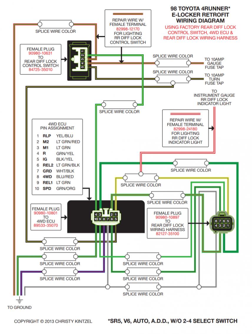

I'm using an ECU I sourced from a junker that I took locker parts from. I used the diagram provided by Timmy. Now that I think about it, that diagram was for a 98, and I recall finding out after some help from you that wiring isn't the same in my 2000 as it is on 98s. I need to double check that.
(EDIT: I don't see a pin location on the B connector of the combination meter for a rear diff lock on my digital FSM copy for a 98-02. I do see it's pin 5 on the B connector of the combination meter in my hard copy of the 2000 FSM.)

There's one clear thing in that diagram above that you *really* need to check. Did you connect the speed sensor wire for the Diff Lock ECU to the dash harness in any way? Because the diagram there shows it connected to ground (which is fine - it allows you to engage the diff lock at any speed) - but if that is also then connected to the wire that is needed for the ECU, cruise control, etc. those other functions won't work.

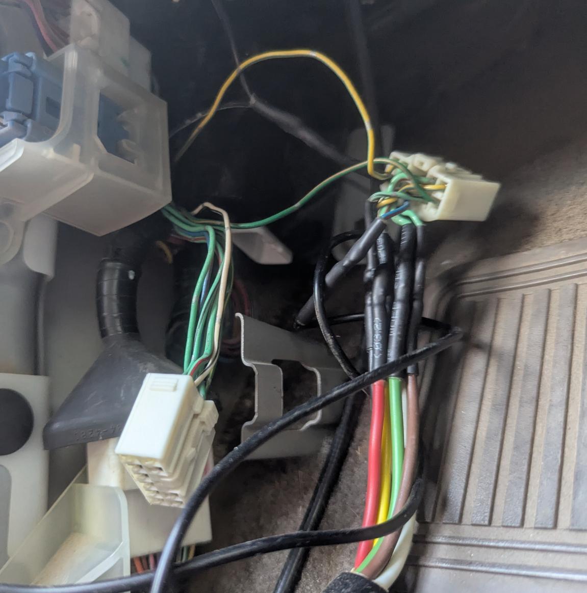

What I ended up doing was making a "new" plug from a sourced pigtail. The plug hanging down is the original plug. I removed the green/orange wire from the original, and added it to the fabricated pigtail. It is not grounded. I didn't want to have the locker connect at an unsafe speed. I did wire it to engage in 2/hi/low.

Update... Your comment about that wire connection got me curious, so I unplugged the locker ECU and returned the truck back to stock. Low and behold, the ECU is reading speed again, and the CEL is gone. I've been tormented by this for so long, and that's all it took. Thank you sir. Now I have to find out what the issue is with my locker ECU wiring. After I get through emissions first of course.
