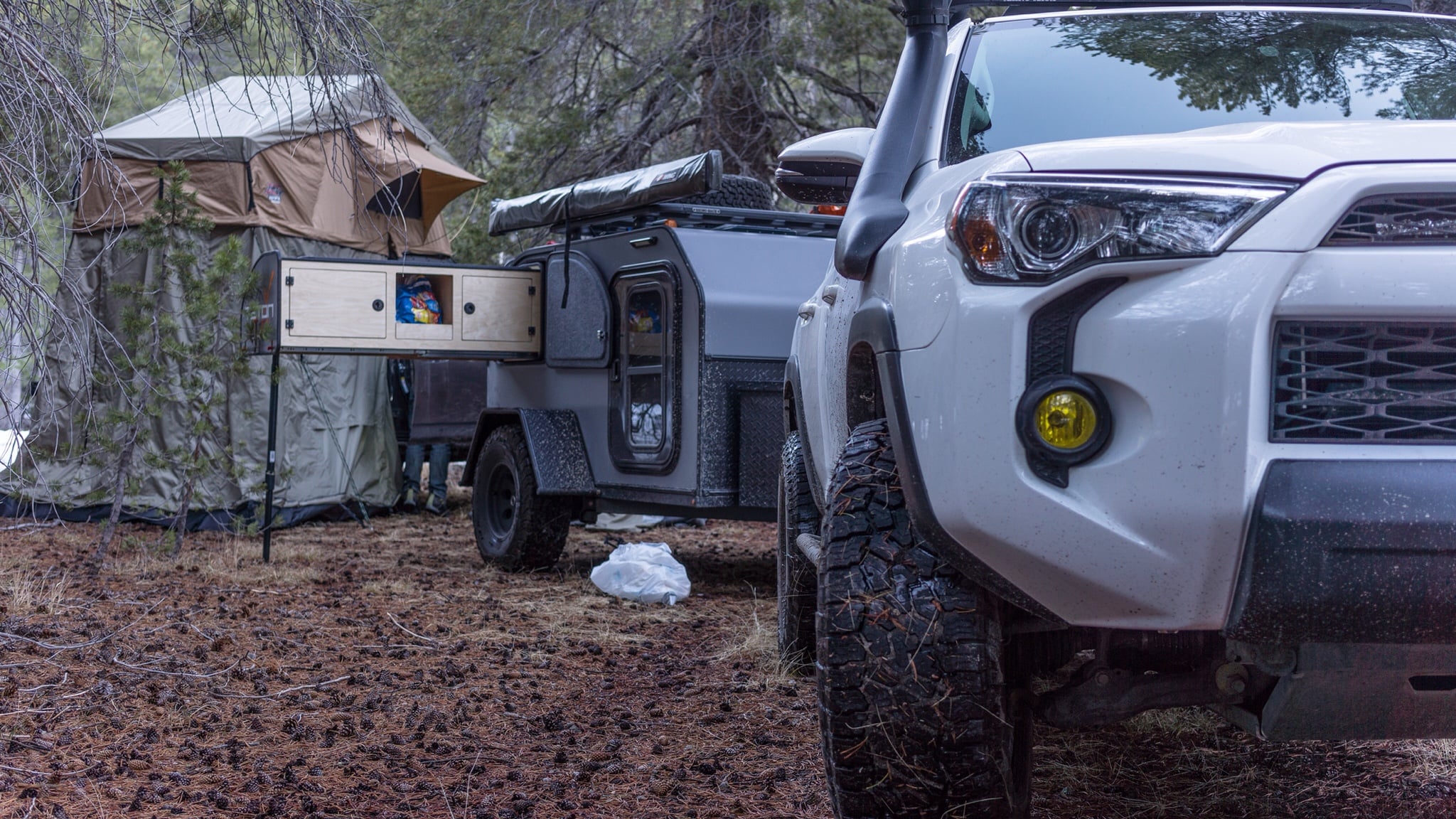

Okay everyone, its time for gears. The truck is mostly stock, just a lift, rack and 33's. The reason im looking at gears is i town an 1800 lb off road trailer on the weekends and would love a little help going up hills and such. Right now im looking at 4.56's gears from Nitro. The question is do you think gears will help with towing the trailer and will the gears be ok to live with while just driving around town without the trailer.
