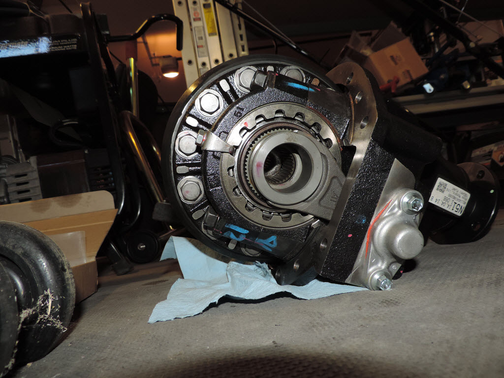

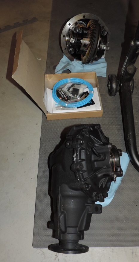

Here is what ECGS sends you.
You have to remove the axle shafts, drive shafts, and the diffs. The front diff is a heavy awkward PITA to reinstall on a creeper on your back. The parking brakes were a huge PITA for me as well, but now after recently pulling them apart and back together to replace a parking brake cable, they aren't bad. Trick is to use safety wire to keep the hold down springs and hardware together and compressed through the hole in the hub while reinstalling the shoes.
