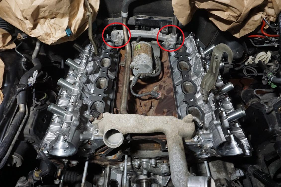

The coolant bypass pipe is difficult to see with the intake manifold installed. Here's a picture showing where the two gaskets are located.

I'm pretty sure you won't be able to see/find that coolant pipe/hose from under the vehicle because it's under the intake, you can only get to it by removing the intake, you might be able to see it without removing the intake by using a "snake camera/bore scope" with a light on it and snake it in and under or coming in behind the intake.
Search the forum for any topics on replacing the V8 starter and you might find photos of the coolant line/pipe/hose under the intake, I'm pretty sure it a coolant pipe that uses o-rings to seal it, but It could be a hose, it's been a while since I've read about replacing the V8 starter.
