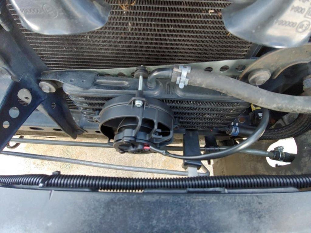

If your going to be towing 20k miles a year like you mention in your other thread, transmission fluid exchange would be a good idea. Make sure your trans cooler is flowing good and you could put a small push fan on it to keep some air moving across it during slow speed conditions. You can either put in an analog guage to monitor trans temps or use an OBDII device.
AWesome never thought about the small fan. I currently change the trans fluid out aound every 25k miles or every year. Been travelling fulltime around the country now for 3 years.
I am interested in adding that little fan . Is there a write up on this and is it on a switch or always running?
Well, the pic in my post is just my half ass rig that I installed with plumbing strap to fasten the fan in front of the cooler. It has been a solid mount though, and I beat this truck quite regularly. Here is the fan that fit my stock trans cooler:

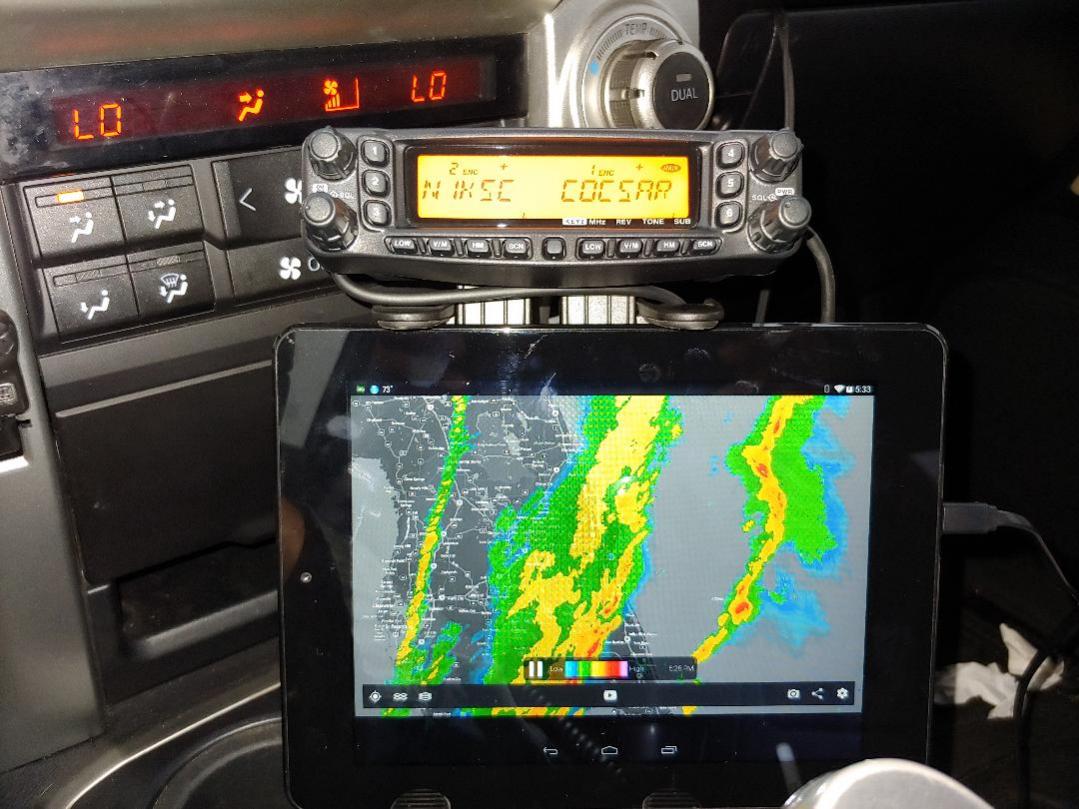

Here is the set up I settled on in my 5th gen with my tablet and Yaesu on an Arkon seat mount. I can navigate and do weather on it as well.

As far as control, you can either put in a temp sensor with an auto switch, that has to be plumbed somewhere into your trans fluid hose then it will turn on the fan at a preset temperature. Here is one example:
Unusual Activity Detected - Free Shipping on Orders Over $99 at Summit Racing
or you can put in a manual switch and there may be more options I'm not aware of.
I never tow and only want the fan to run when the trans gets overly hot during off road sessions. I have the Bluetooth OBDII Android app Torque Pro to monitor the trans temperatures. I mainly need the fan when I'm having to go through heavy sand and there is not much air flow at the slow speeds typically found in this situation, but it raises your temps quick and they will stay there.
But I don't need the fan all the time, and didn't want the battery/Alt drain, so I opted to direct wire mine with a fuse straight to the battery and a switch inside the cab. The switch I used was a cheap push button that fits in our empty slots either on the dash or on the console.

The Auto switch will most likely be your best bet, given your driving/towing needs.

Awesome thanks for that info i think my best bet would be to have switch on mine and always run it while on the hwy and towing for long periods of time the cooler the temp stays the longer the trans will last. I need to get one of thpose obd2 blutooth readers to keep in my obd2 port so i can monotor things . So far i do not monitor any temps and have been doing this for 3 years now while towing long distances
If you put the pusher fan on a manual switch make sure you use a power source that is hot only when the ignition switch is on or your risk draining your battery if you wire it direct to the battery, etc. if you forget to turn off the fan when stopping for a while or parking it.
