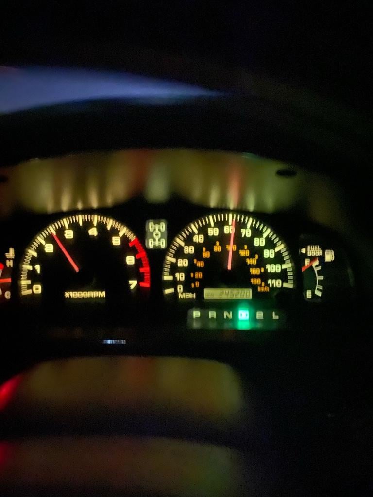

So I went with 5.29s
I guess I’ll just have more of an excuse to get the 35s on sooner rather than later.
So happy with the 5.29s
I seriously thought that it was going to bug me until I got the 35s but it feels amazing.
Did the initial break in and drove 60 miles with 2 pit stops in between to let things cool down.
I honestly couldn’t be happier.
Now to see how they feel on the trail.
I'm super stoked for you, and from past experience I know that going too conservative on gears is usually a mistake. I'm contemplating regearing and having the same internal debate with the 5-speed manual caveat of lower trans gears...
Looking forward to your trail report
