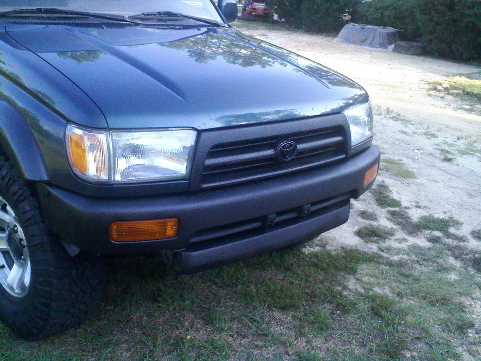

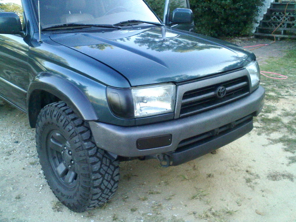

Nothing wrong going with your plan of painting but will take some work. You'll need to scuff up your bumper and remove the rust. This is probably not the preferred method but I would put some duct tape on the backside of the hole in your bumper. Get sum bondo and fill the hole. The tape on the back will keep the wet bondo in place until it dries. Then remove tape and sand bondo flush with bumper. Apply primer and paint your choice of color. Or you could bedline and spraypaint the bedliner your color of choice. Which ever you prefer.
bedliner with no paint (top) bedliner with rattle can metallic charcoal (bottom)

Yay i was looking for someone to give me an idea of something like that a cheap quick fix. Il be doing that. I was thinking about keeping it chrome which is a pain in the ass i think it makes it stand out. But I shall see.

How are you planning to keep it chrome? I've never used the chrome spray paint since I'm more into D-chroming.
