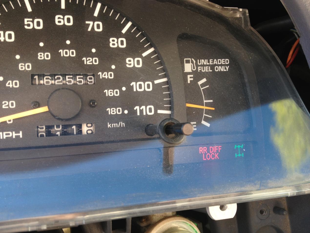

to get out of 4wd you may need to put your truck in reverse to back up to take the "tension" off of the drive train components. sometimes it is necisary to drive in a figure 8 pattern to to unlock the 4wd system, this is why it could be help full to drive to the grocery store in 4wd and then once there, find an empty part of the parking lot and take your truck out of 4wd. on your dash their should be a green light that has the 4wd indicator that looks like the one below photo (2).jpg if that light is on solid then you are in 4wd, if it starts blinking right after you shift into 4wd, then you are not in 4wd yet and there is something wrong, and if it starts blinking after you shift out of 4wd then you are not yet out of 4wd and something is holding up or not free... that light blinking means something is not right and needs to be checked or fixed as the 4wd system is not working properly. it is also common for that light to stay on for a short time after shifting out of 4wd -again back to what i said about needing to back up or drive in a figure 8 or back up in a figure 8 to unlock or take the tension off the system to free it.

I do appreciate the input! One last thing would be my question on the picture you posted. Next to the light it says "RR DIFF" Whenever I have used 4wd on my 4Runner...I only see the green 4wd Icon...any final input on that?

that light is an indicator for vehicles equipped with the locking rear differential. if you dont see that light, dont worry. you probably dont have that feature on your truck so its a mute issue for you.
Just to add a little clarification. The light you are referring to that says "RR DIFF" is the indicator that tells you that the E-locker in your rear differential is engaged. As mentioned. This only applies to vehicles equipped with this option. If yours has it, you will have a button that says "RR DIFF" on the dash, just to the left of your steering wheel.
