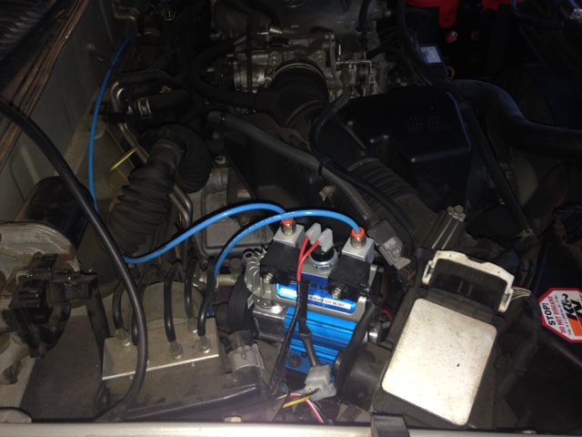

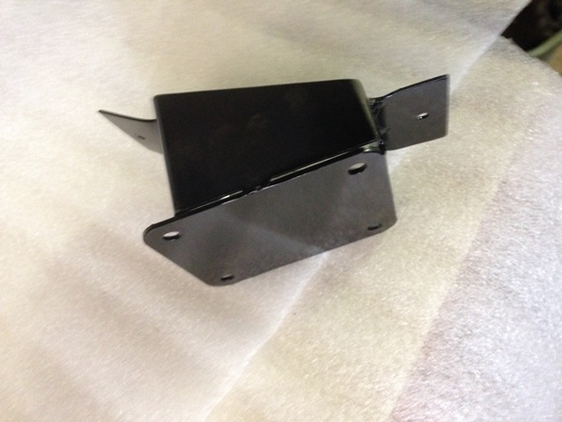

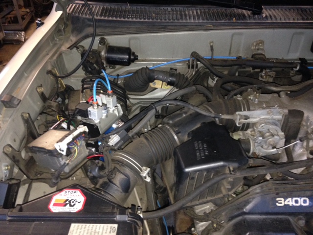

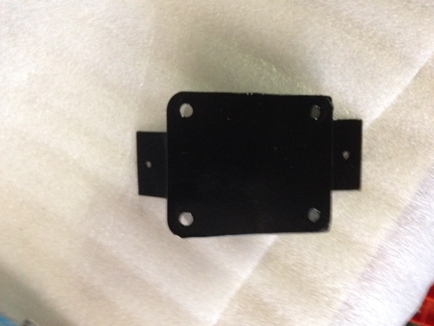

So I got back to work on the runner. Made a mount for the ARB compressor and ran all the lines.

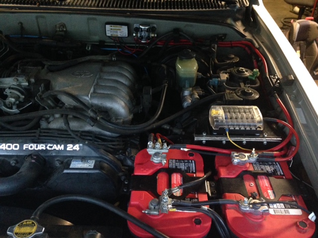

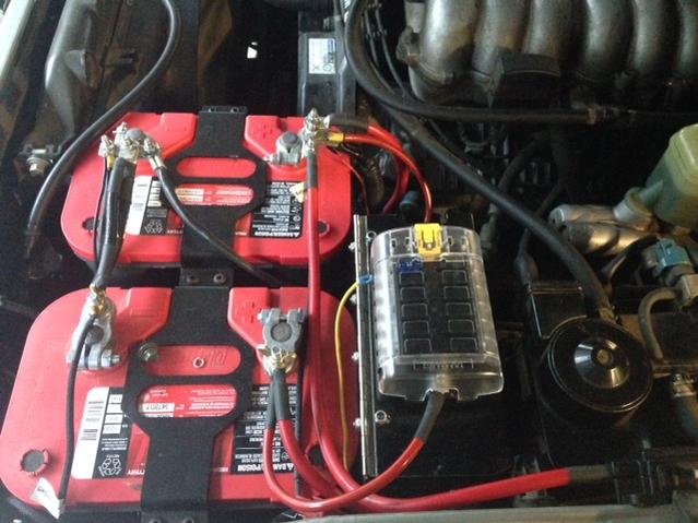

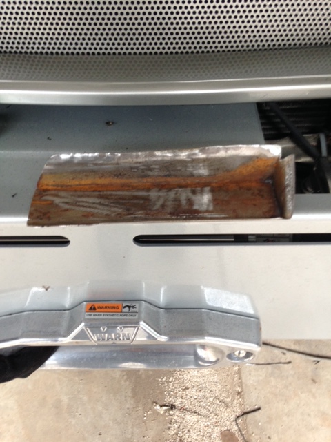

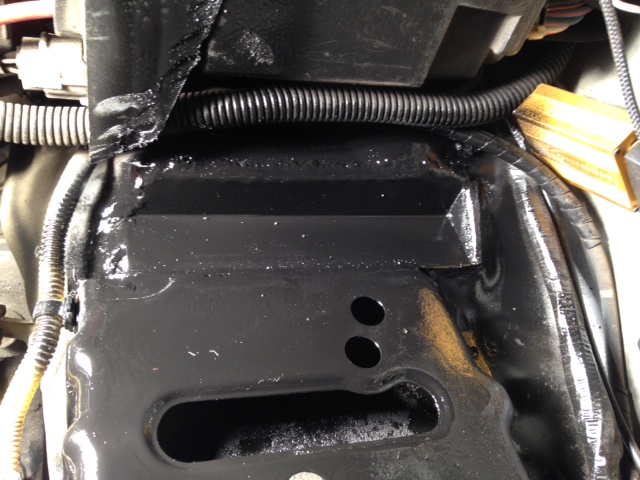

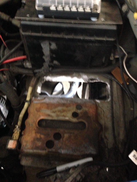

Then I started on the dual battery set up... What a pain in the ass. To get them in the way I wanted them I had to cut the inner fender out and make and weld a new piece in

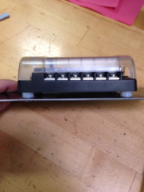

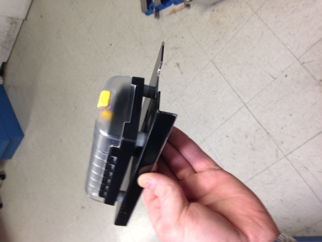

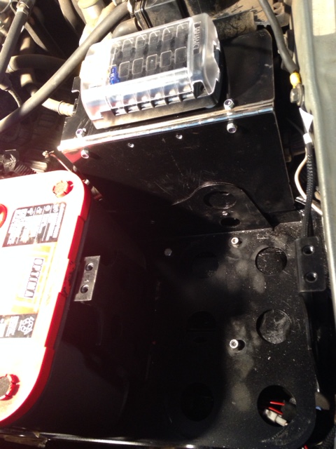

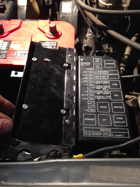

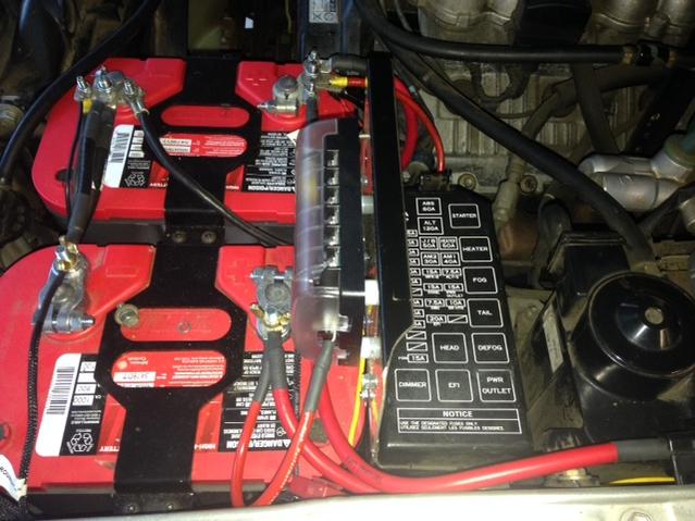

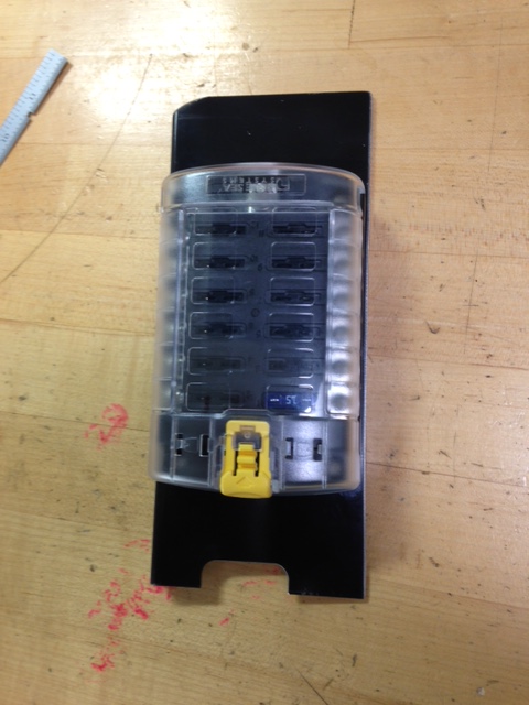

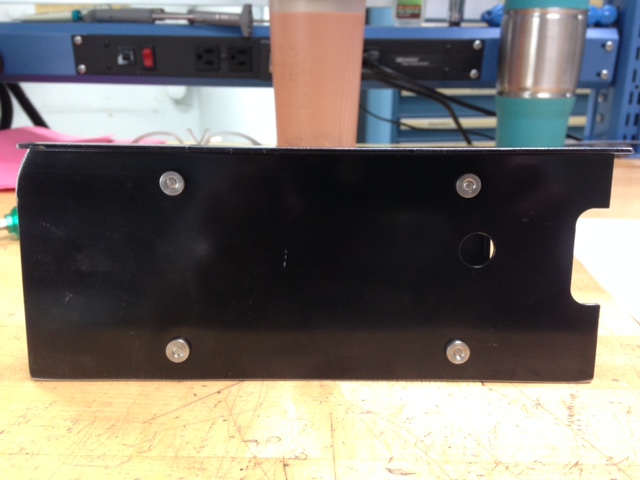

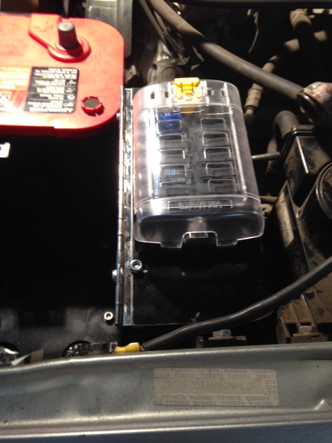

On top of the dual set up I wanted to add a fuse block. So I made a hinged plate and bolted it to the battery tray. Mad it so I could still get to the stock fuses.

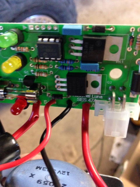

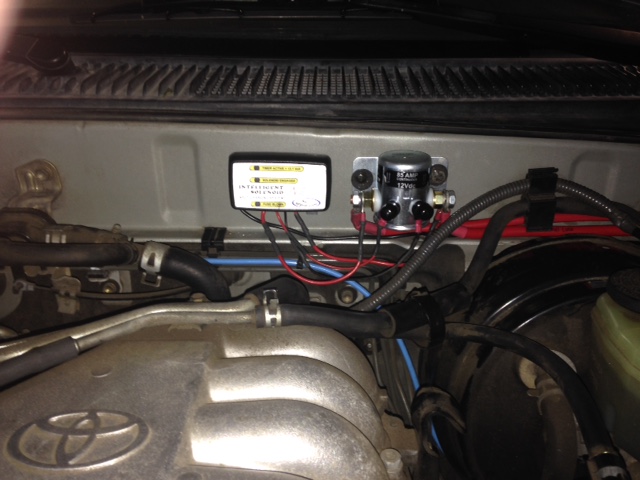

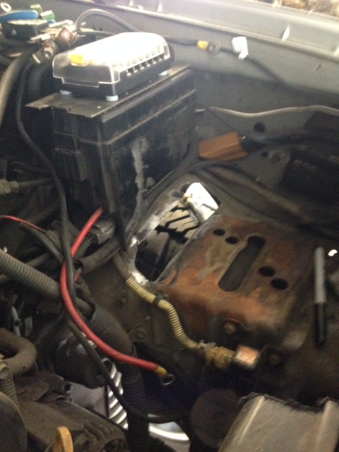

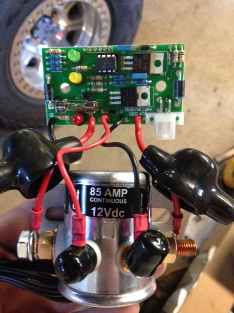

I couldn't find a good spot to mount the plate that the solenoid and the load manager so I took them off the plate and had to extend all the wires so I could mount them on the firewall.
So it's almost done, got all the wires run, cables made and everything working.

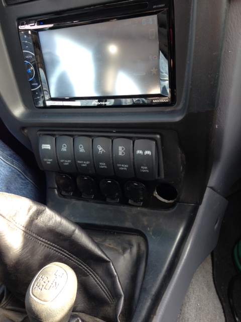

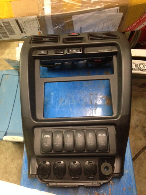

Then it was time to move to the inside. I got the center dash piece all put together. Now I just need to wire all the switches.

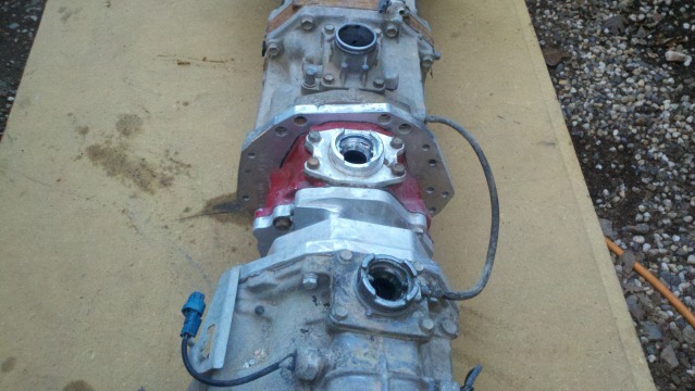

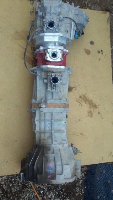

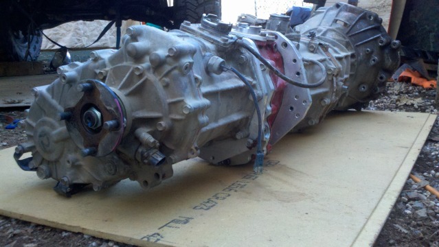

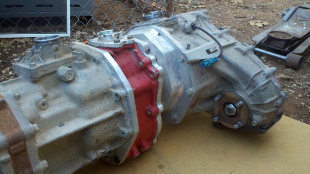

So she's back in the garage, getting ready to put in the duals. I think I'm going to use my 5speed and rear case and just use the adapters and 4:7 crawl box. Not for any other reason than I know my trans and Tcase history.
Yes, I know...I'm adding more bolt on stuff:biggrin2:
