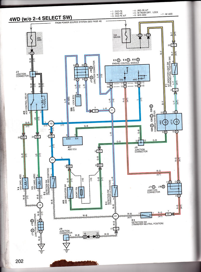

Looks like wiring to me. I would:
1) Jump ground to that blue wire Pin 2 (OOPS, blue is on 2 not 4!!) on the relay with 4H engaged.
2) If relay engages, run a by-pass from blue wire on TC switch to Pin 4 on relay and see if THAT engages.
3) If so, we start tracing that blue wire from TC to relay until we find the fault. It would appear that it has to be in the first leg, between the TC 4H switch and the I11 connector where the 4L signal comes in. I11 is a ten pin dark grey connector behind the glove box.
The issue with your cross connect idea is that you would trigger whatever morph the ECU does when 4L is called when you are only in 4H. I have no idea what the ECU does in 4L, but it probably limits you somehow. I assume it disables ABS, but I don't know if it limits revs or something as well.
Take a close look at your connector on your 4H TC switch. Hit it with contact cleaner and compressed air. I bet the issue is right there. Test continuity from blue wire on TC to Pin 2 on the relay before and after cleaning.

Awesome. The schematic is a huge help! I still think its a wiring problem since I jumped the blue to the ground at the transfer case and still nothing.
