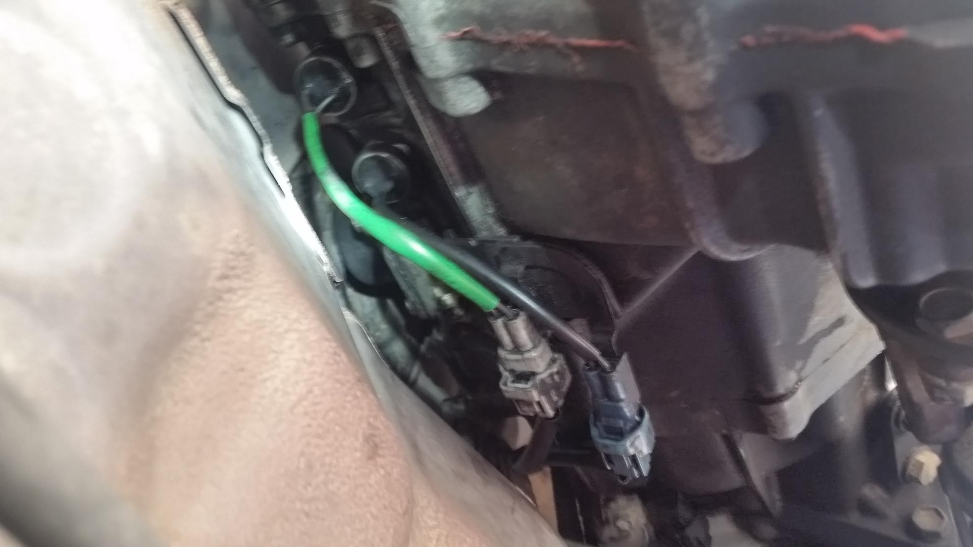

The 3 plugs for the switches should match colors (blue to blue, grey to grey). It looks like 2 are blue, so make sure they go to the right places. You can kinda see here how two go to the pair of switches and one goes to the other side:
In your first post, it seemed that the "Low" switch and the "4WD" switches were swapped.

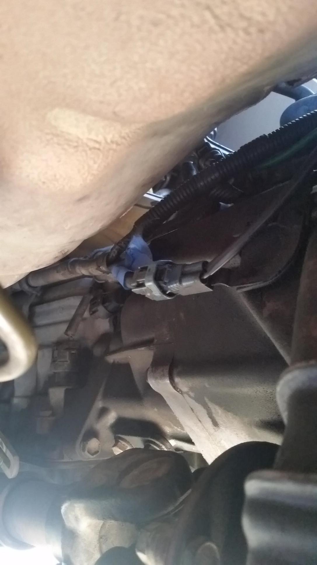

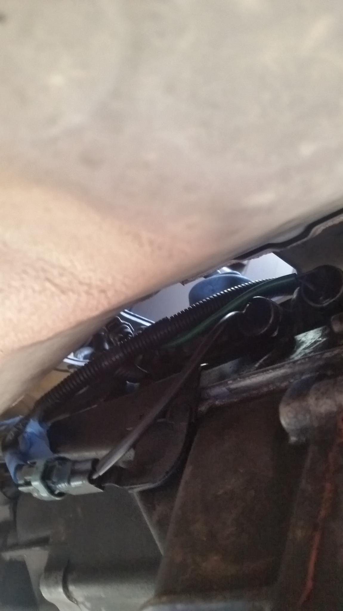

OK so here is my truck sorry the pictures not the best.. but the blue tape is the driver side of the truck... you can see the black and green switch. It looks like my blue switch is flipped or am I crazy? im using the other picture posted on here to compare
Glad you got it! Your wiring was flipped between the sides of the transfer case - compare to the picture I posted above!

I don't even know how you find that picture I looked everywhere and couldn't fiND anything with trans and wiring still mounted
Its my own picture. I took it to make sure I put the wiring back in the right place when I did my 4WD swap. :madgrin:
It was a wrecked truck and had a cut harness at the belhousing, so I was able to keep the trans wiring in place when I pulled it.
