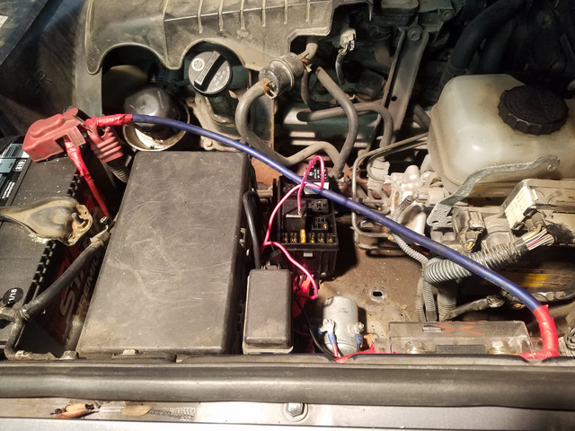

Auxiliary Relay Box. Screwed up the planning for the fuse to batter leg of the dual battery setup. That line (blue) will have to be re-run to clean up the look.

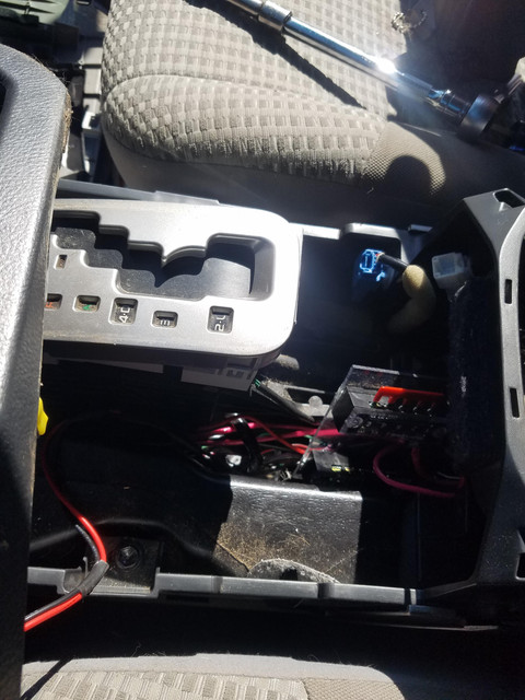

Got the RPi touchscreen case in today, so today's project will center around getting things integrated cleanly; shortening and re-pinning jumper cables, deciding which GPIO pins I want to use "officially," and reconfiguring the relay board to operate how I prefer.
I fairly certain I am going to install this in the spot just below the enviro controls. If I remove the hinged drawer and install a new hinge that would allow the screen to rotate up or back, I should be able to have a unit that doesn't interfere with the cup holders during everyday driving instances.

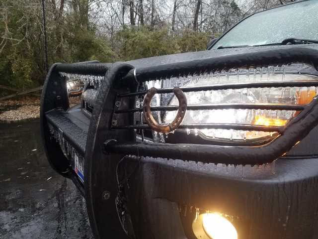

just out of curiosity how stable is the grill 'guard'?
i had a couple over the years and even mounts with 4 fixed tie in points they wobbled enough that the auxiliary lights beams bouncing all over the place drove me nuts.
I love the idea of the Raspberry Based touch screen. Way cheaper than some of the other touch screen options out there and doing it yourself puts a huge wow factor on it
Mine vibrates a lot, but I think it's just a perspective disconnect between how much the frame vibrates relative to the chassis. That said, I may brace it in the future.

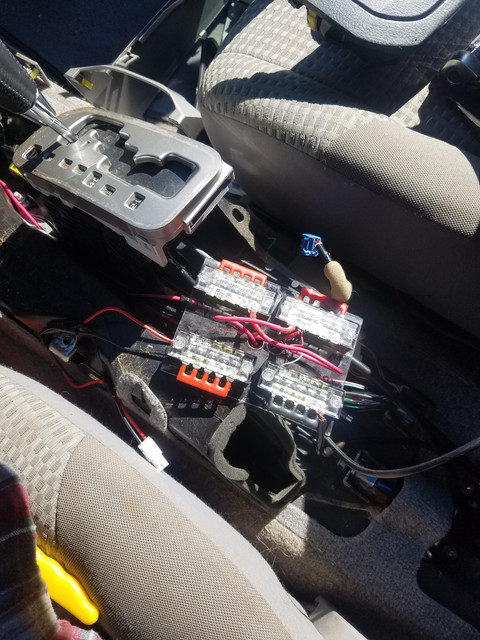

Built and installed 4 rails for powering everything. 12V, 12V RUN, 5V (for microcrontrollers), and Ground. 5V will be regulated by a Buck converter, which will keep the output voltage stable through the vehicle's voltage swings between 11.5ish and 14.7V.
It's a bit tight, so I'll have to compress its footprint in the future.
