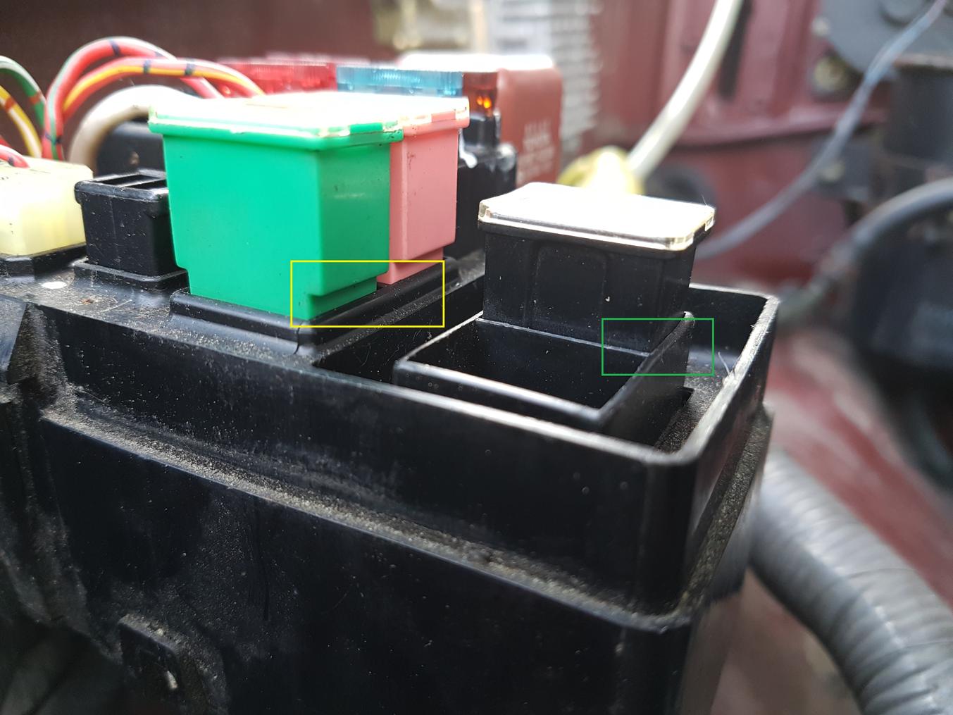

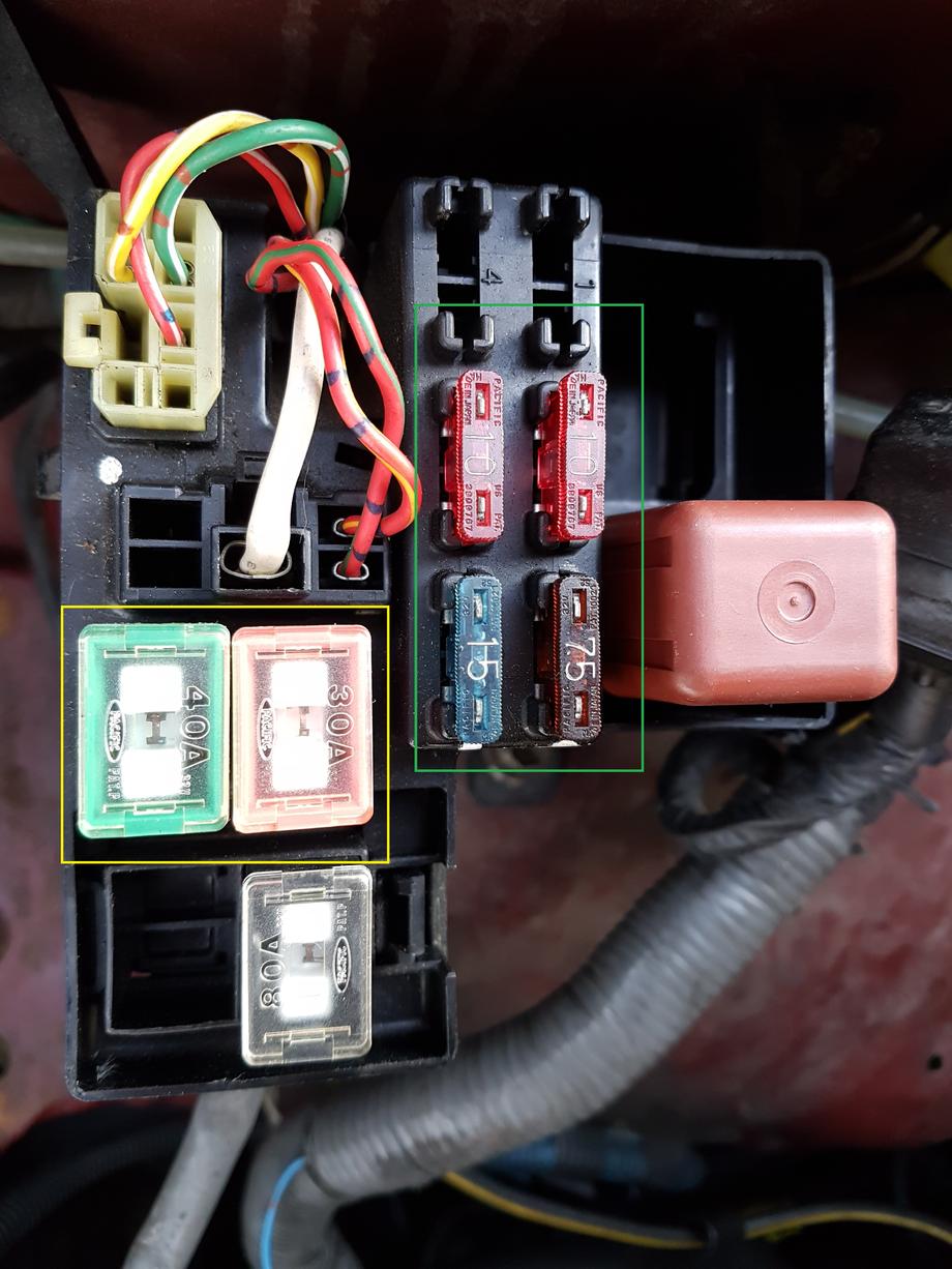

I've checked the engine fuse box, everything looks good, but the ones in the yellow box don't fit perfectly, they're not fixed, they're lose.
The second photo show it better, they're in higher position than the 80 one (black), could be a problem?:

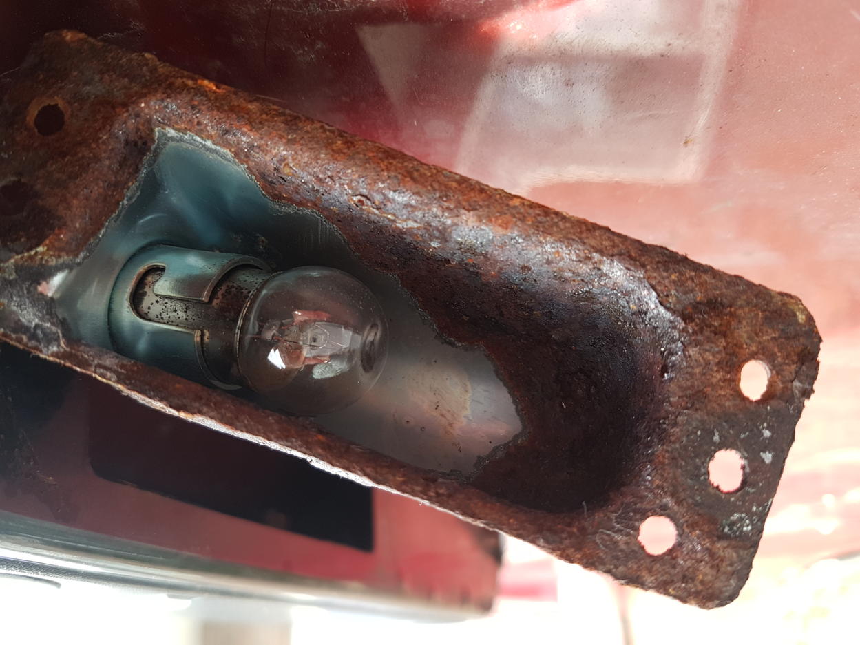

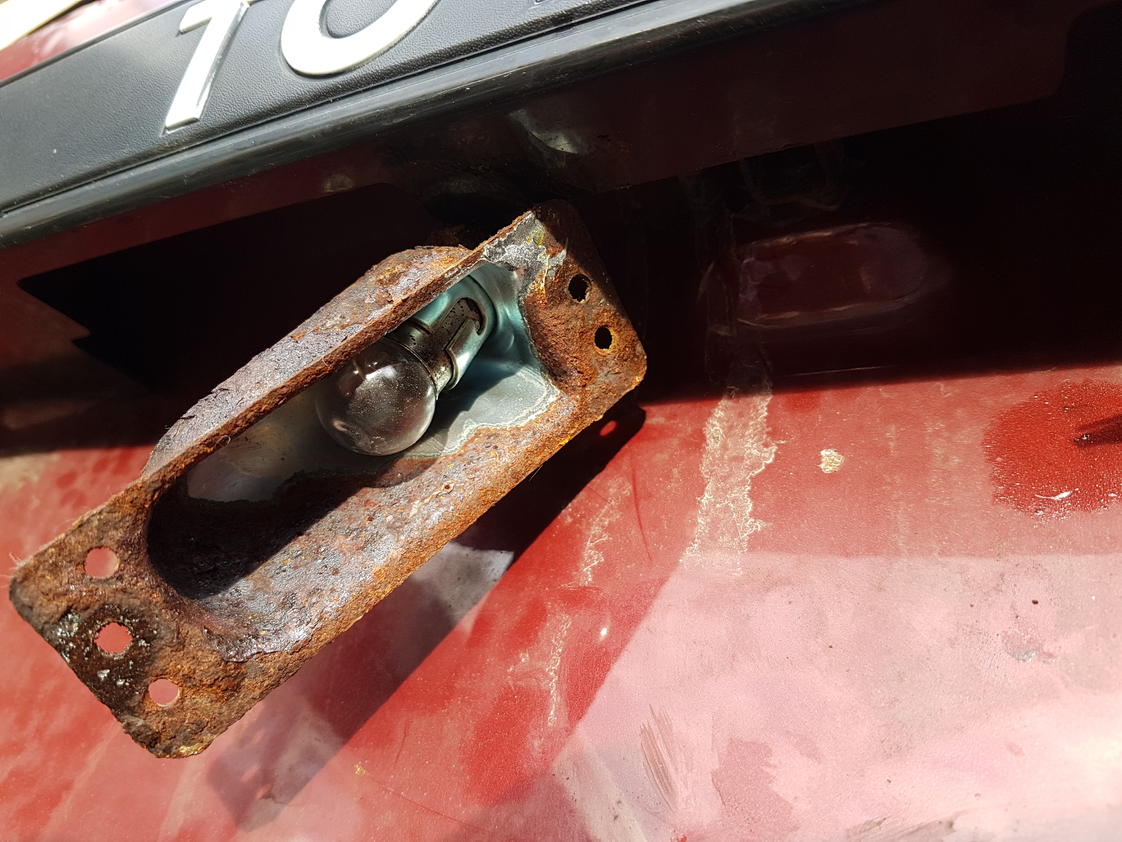

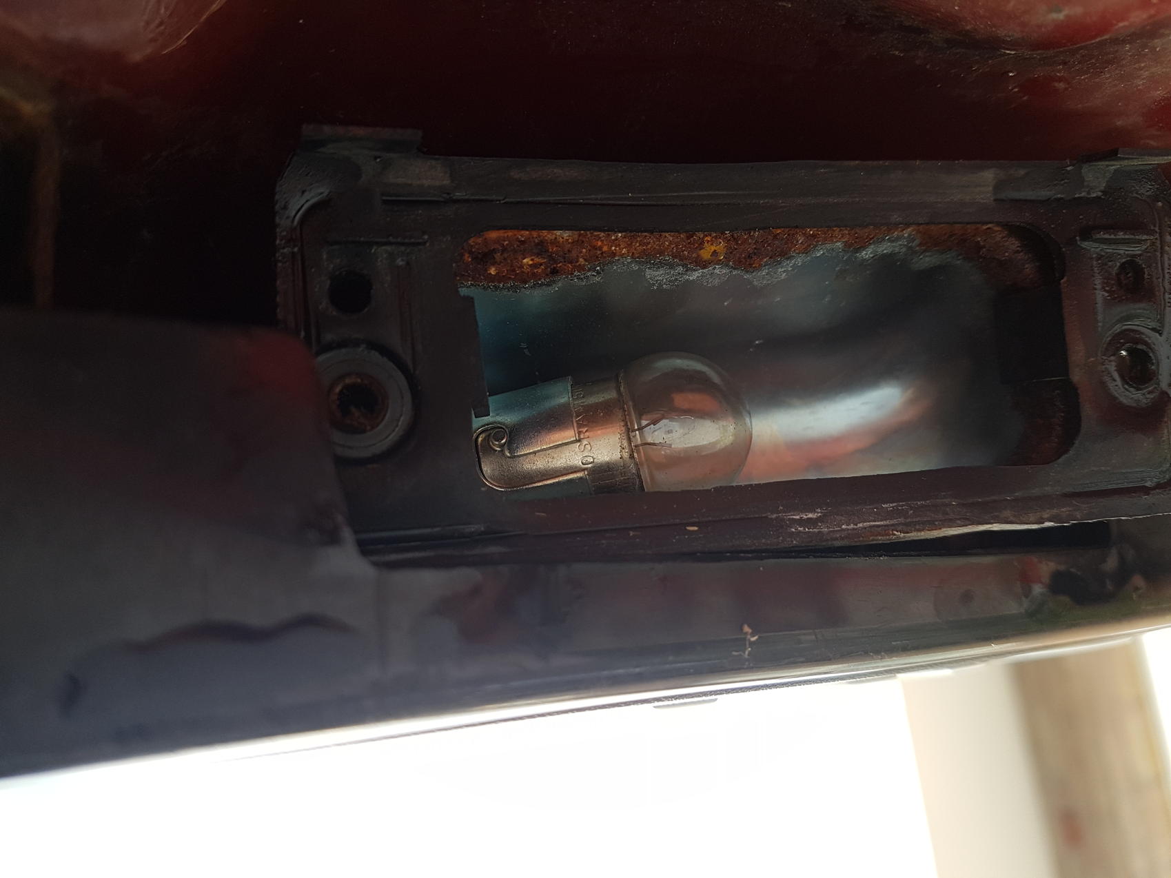

But I think this's the problem, the light bulbs're good, but their 'ass' and their holder have seen better days, what do you think?

First I'd change the back up lights holders and light bulbs. I have to go for the replacements. Do you think could be the same thing which affects the turning lights? The 15A fuse's good, that goes to the back up lights and the comb light (combination switch?). I think this's the problem.
What about the 'loose' fuses? Should I push until they're completly fixed? I don't want to break anything...
They are fusible links and don't pull out like a normal fuse.
IIRC they're screwed in from underneath.
They're the main 'fuse's for the entire vehicle, so if they were loose you wouldn't run.
It can't hurt to check them out, but make sure to disconnect the battery cable first.
It makes sense. I didn't know these kind of fuses, I pushed them but they didn't fit :redface:

I'd recommend cleaning up the light housing as best as you can if you're capable of doing it solder a wire directly to it then run that to a good ground.

Those rusted light sockets are for your license plate lights. Those are on same circuit as tail lights, not affected by ENGINE fuse that supplies turn signals, back-up lights and rear washer/wiper.
If they do not work, do as airdreams suggests above^^^
If they work, don't worry about them. Focus on the more important issues first.
The 30-amp and 40-amp are fuses. They plugged in an look mechanically OK.
The 80-amp is the fusible link. It is screwed into the fuse block from below. IF your headlights, tail lights, gage cluster lights, and hazards and horn work, you now that the 80-amp fusible link is good.

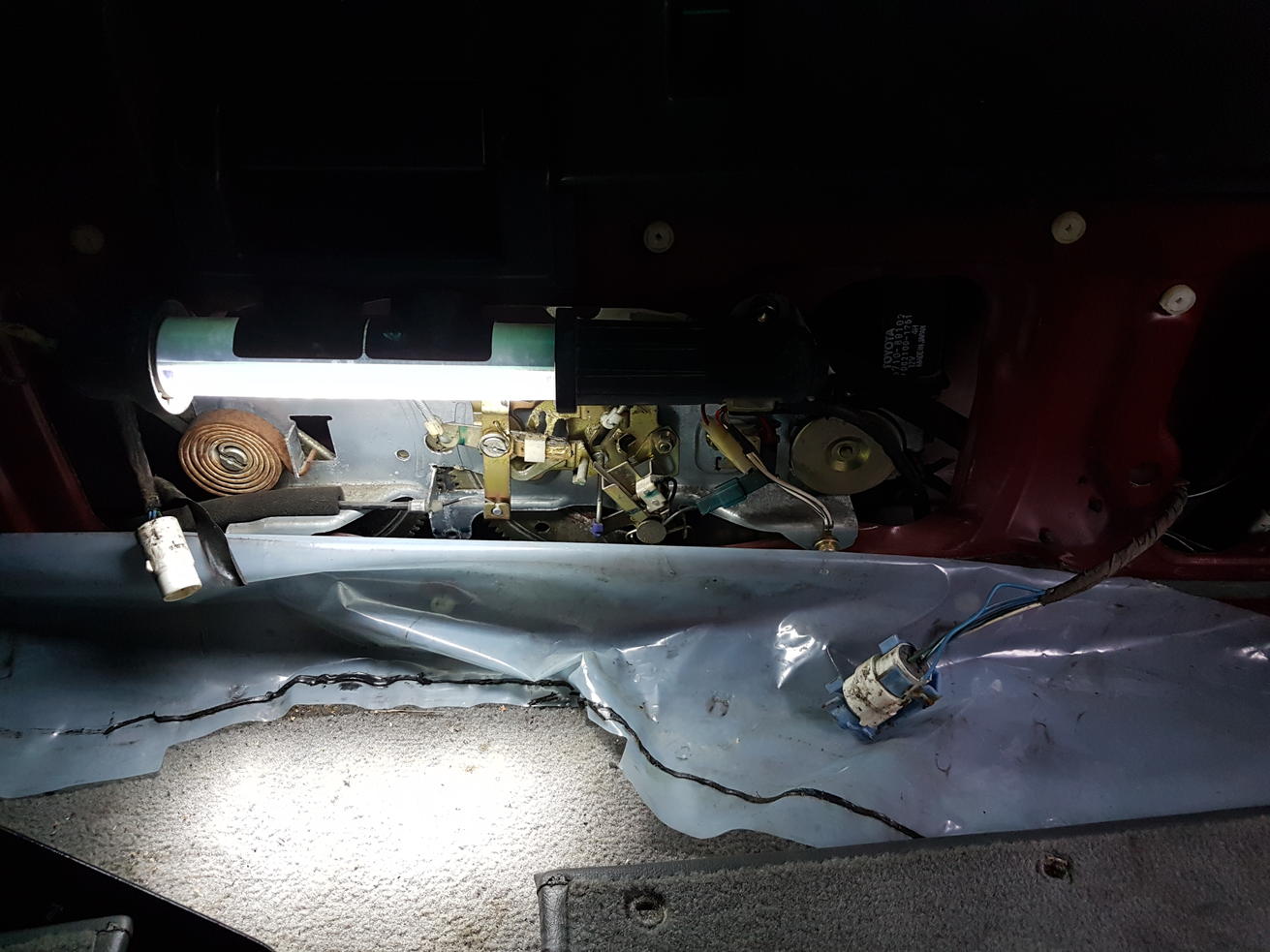

I'll follow your advice, but I'd like to show you what I found:
In the photo. Those plugs were disconnected, wet, dirty and rusty. If I'm reading the FSM correctly, those connectors are from the windows regulator motor, but the rear window works perfectly (By the way, I have to work in the interior of the tail gate, it's rusty, it looks like water finds its way, corroding mechanism, connectors. etc)

It's common for the top window seals to go bad and let water in. Most of us older guys drill holes in the bottom to let it escape. It was a poor design from the factory and even brand new they leaked into the tailgate.

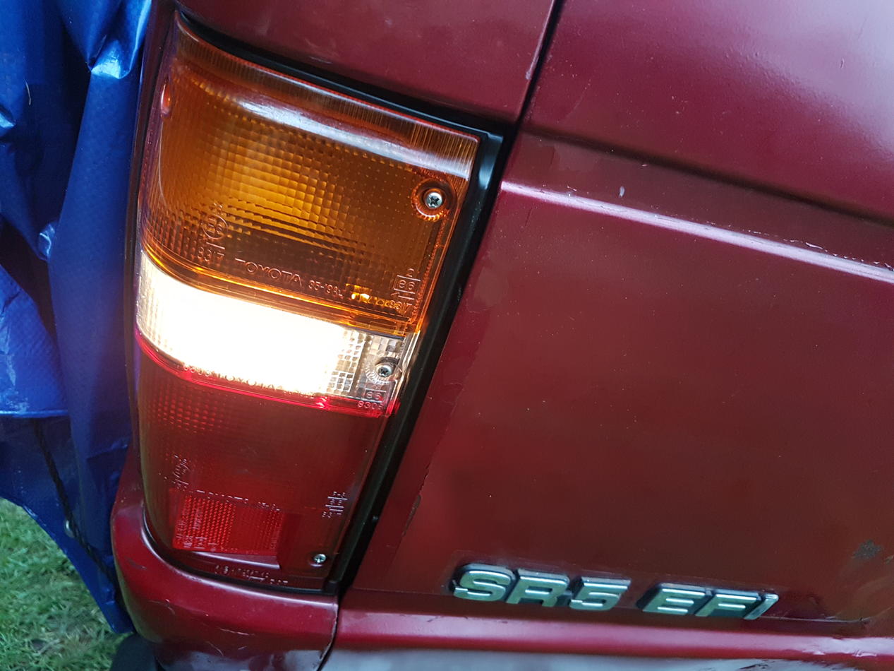

It's alive, IT'S ALIVE!!!
Thank you very much RAD4Runner!
For other people with electrical problems: Procedure for checking engine fuse is here.
