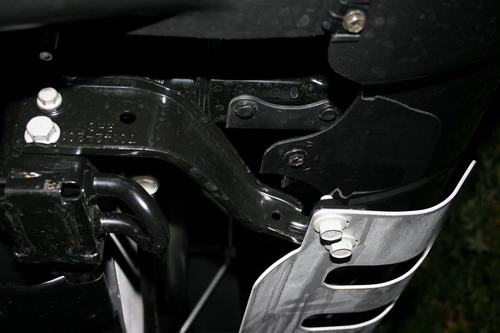

For my 2006, it is quite different than momo75 has. Here is the picture taken on the passenger side mounting of the skid plate.There are 4 white bolts on each side and the black bracket. The two bolts that were mounted on the side, the bottom bolt is bigger and fit to the thread on the 4runner, the top bolt is smaller was mounted on the hole with no thread, there is a device that come with the kit to mount the smaller bolt.
If your 05 or earlier 4runner has thes two holes on each side, then it probably will fit.
AlexJet said:
No. If you look carefully, you'll notice different mounting brackets and mounting holes (new are oval). momo.75 has installed his skid plate using towing hooks. The new one looks like using frame as for mounting surface. It's better choice for the skid plate.
Looks like I have my brush guard mount there.

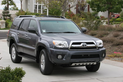

Here is the Toyota skid plate mounted on a 06 SR5.
00328 said:
Unison845 - Can you post a pic of the front of your runner with the skid plate installed?

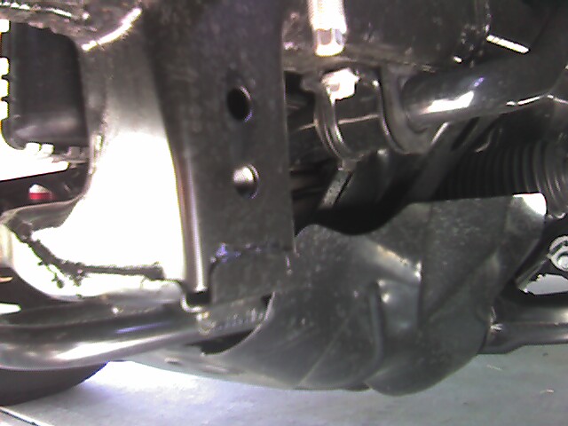

my 05 limited has 2 holes on each side, 1 with thread and 1 without
