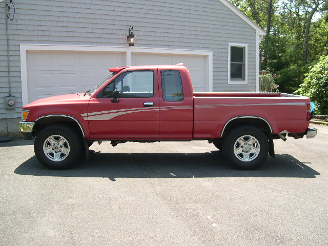

Pics of rims on truck
Here is a pic of the rims on the truck, I know, I need a serious compounding on the paint job, lol.

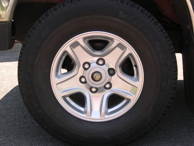

center caps
Here is a closeup of the rim with center cap cut out in the center. It didn't come out perfectly centered (Coors Light induced) so I'll probably pic up a couple and redo them perfect now that I know it'll work. I might go an 1/8" smaller on the hole saw as well for a tighter fit.

Thanks for the compliments, they worked out well, I had been wanting these rims for quite some time. I plan on painting the dust caps silver to match the rims when I have the time, I just wanted to get them on the truck. If the hole was enlarged I'm sure it work with manual hubs as well.

I have no knowledge about the spacers, I wouldn't want to guess. The dust cap sticks out 3/8" to 1/2" beyond the center cap cut out.
